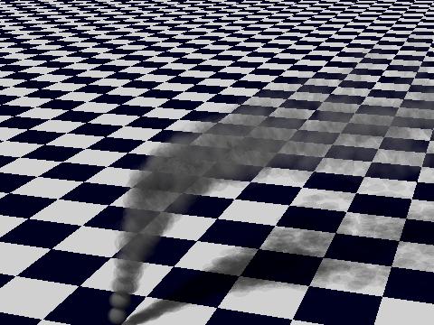

I have been working on a simple particle simulation for atmospheric
effects like smoke, and here is the first result. At the current stage
it simulates gravity, particle temperature(high temperature particles
rise faster than lower temperature particles, and particles constantly
cool), and wind.
No media was used, just a whole bunch of partly transparent spheres. The
render time is tolerable with smaller amounts of particles, but really
slows down where many are densly packed. And of course, a high
max_trace_level has to be specified.
Parse time is a bigger problem, I tend to get impatient with the speed
of parsing POV simulations. In this case it was about 12 minutes, with
1500 particles and an iteration level of 300(the simulation simulates
the path of the particles by going through several iteration steps,
incrementing the position each time). Of course, that is using MegaPOV
0.4, so it is using the faster macros.
It is animation safe, although I have only done one test animation. The
parse time builds up quickly, but I will try to make it support
MegaPOV's persistant variables, which will help quite a bit.
If there is interest, I will add some finishing touches to the source
and post it. I will probably make a C++ version someday, it will run the
simulation much faster.
Chris Huff
e-mail: chr### [at] yahoocom
Download 'ParticleSim.jpg' (52 KB)
Preview of image 'ParticleSim.jpg'

I've seen a lot of this partical stuff, it is quite realistic, I have never
tried it myself but from what I hear some of it is quite demanding on POV.
Looks promising.
>No media was used
Impressive.
Well, it is POV. :)
I can imagine, however I would hope that this would not be an obstacle
in your continued work with this project.
I think this is a given. (That there is interest.) If you do find the time
to finish it up and post it, this would be great. A C++ version would
only be a plus (no pun intended).
> cool), and wind.
The effect looks promising but the black/white checker floor hurts the
demonstration.

In article <389803C3.BB89C135@pacbell.net>, lin### [at] povrayorg
> demonstration.
Well, I needed something that rendered fairly fast for my test renders,
and which gave different background colors so I could adjust the
transparency right...and I am actually more bothered by the fact that
the smoke is appearing from nowhere. :-)
I think the next thing I will do is use trace() to try to get it to move
around objects, and probably also add "attractors" which attract or
repel the particles, a sort of point gravity source.
Chris Huff
Like in Star Trek where they have the attractors and repellers and twisters
and they put them around the ship when it goes through space dust?
BTW, couldn't you make this with your blob pattern using media?

In article <38984029@news.povray.org>, "TonyB"
> twisters
I am not sure what you mean...the Voyager intro sequence?
Something like that, anyway...I hadn't thought of the "twirlers" though.
Yes, I could, and it would get rid of a lot of the problems with the
large amount of transparent surfaces. It would also slow down with large
numbers of particles, but it could possibly be much faster than
transparent spheres...and I could optimize the blob pattern to make it a
bit faster with large numbers of components. I will probably include
this in the version I release.
Chris Huff

Real neat stuff, as long as you don't examine the shadows to see those spheres.
Very plausible effect for smoke.  Sounds like a great candidate for animation if
it weren't for the long parses.  Hope to see more of it later.
