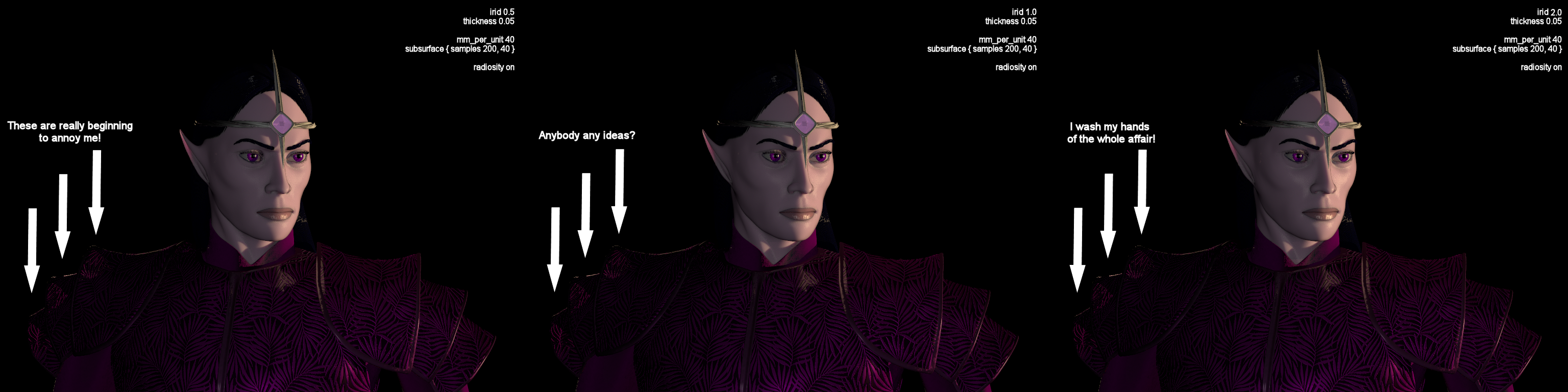

Since I have been told that I am a very naughty boy and must not use
assumed_gamma 2.2 nor misuse irid in any way shape or form, I have reworked one
of the images in accordance with this new theology.
Points of note. The meshes need severe sub-division, the more the merrier. I
also ran the gamut of 20 to 50 mm_per_unit for SSLT and settled on 40. Irid is
really good at highlighting the normals which SSLT tends to hide.
But ... is this necessarily a good thing?
Simon.
PS. I do have an excuse for 2.2, though! CRTs! And POV-Ray versions 1, 2, 3,
3.5, 3.6, 3.62......... And CRT's! Do NOT forget CRT's!
Download 'ssltvir01.png' (1226 KB)
Preview of image 'ssltvir01.png'
From: Simon J  Cambridge
Subject: Re: Irid vs SSLT redux (with less assumed gamma)
Date: 2 May 2016 08:55:01
Message: <web.57274da1aca34b78acfa7bc90@news.povray.org>

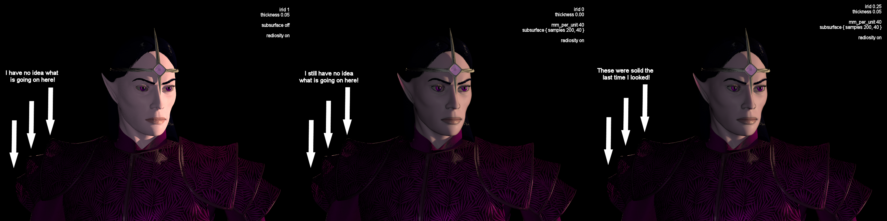

And the second image continuing the theme.
I also changed the lighting so that you can see SSLT occurring in one of the
ears. It is probably manadatory to have SSLT occuring in at least one ear.
Download 'ssltvir02.png' (1159 KB)
Preview of image 'ssltvir02.png'
Absolutely. For elves, that is. at least for elves. Orcs, not so much.
They usually wear it in their left ear though. Your hero is standing in
front of a mirror, right?
As far as the shoulderwear is concerned: Well, what do you expect? Looks
to me like the thingumajigs receive light, with shadows from objects
further to the right that happen to almost coincide with the tips.
Nothing surprising to me there.

Actually, the being depicted is not an Elf! (And in making such a rash and
unwarranted assumption you have seriously dented your credibility in the process
- you need to read my books to find out more.)*
The 2.2 thing was an assumption on my part - me being lazy. I am just glad to
find out where I have been going wrong all this time. I will also recalibrate
for both mm_per_unit and translucency and see where I get, but I might still
have to mess with the numbers as the being depicted is roughly ten feet tall.
(You really need to read my books to find out more)**
So here is the question (throwing it out to all and sundry). What do you think
of the texturing? Does it work?
(And the anomaly on the shoulder is a bit odd in that there is no light on that
side and it seems to me that light is coming from behind, through the armour,
which it shouldn't because the texture has no translucency. I have yet to work
out what is going on there.)
Cheers,
Simon.
*An entirely innocent and fortuitous plug.
**Another entirely innocent and fortuitous plug.
www.landofthefirst.com
Maybe try placing a box object there to shield the shoulder from any light.
Use the no_image, so that you can still "see through it" and see the shoulder,
but it will still cast a shadow, if light is indeed somehow coming from the
front.
(Some sort of tool to trace out light rays in the scene, with a setting so that
it would show x% of the rays would be neat, eh? )

With a mesh, you sometimes see shadowing aretefacts where areas that
look as if they should be illuminated been actualy unlit. The reverse
may, albey more rarely, appen : Areas that "should" be unlit may actualy
receive light.
Try scalling your model up by 10, and reduce mm_per_unit to 4 to
compensate, and see what appen. It may be due to some floating point
rounding errors.
