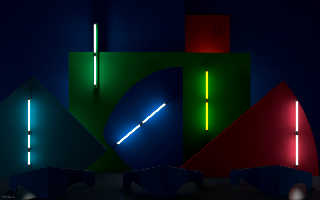

Based on the stage design by art director Yukimasa Okumura for the YMO
performance in 1981.
I used an aged video tape (recorded from Japanese TV) as reference but
have actually seen them life at Budokan in 1983 ;)
This image is basically the result of experimenting with Adobe-RGB (and
it's wider gamut compared to sRGB) as working color space for rendering
within POV-Ray. As my monitor fully covers the Adobe-RGB gamut I can
visually design the colors and push them to the limits.
The interesting and surprising thing is: I do even get more vibrant
colors and a better preservation of subtle texture details when
rendering within Adobe-RGB and converting the final image to sRGB (by
using ICC profiles) compared to defining the colors already within sRGB
and rendering within sRGB. This was something that I did not expect and
after having rechecked my color management pipeline I think that indeed
the diffuse radiosity bounces do produce more vibrant and maybe more
realistic results within the wider gamut.
Sadly the JPEG compression does make things even worse for this kind of
image but anyway here is the (into sRGB converted) JPEG version - quite
poor compared to the full blown 1920x1200 uncompressed Adobe-RGB image
that I currently use as desktop background.
-Ive
Download 'yellow magic (small).jpg' (180 KB)
Preview of image 'yellow magic (small).jpg'
looks great even in srgb ;) (and my monitor would be too old anyway)
Do I understand correctly that you define colors in adobe rgb,
manually convert them to "linear adobe rgb" (x^1/2.2), render in
povray using file_gamma 2.2, reinterpret the output using an
adobe rgb profile and then convert to srgb?
And that this gives significantly different results compared to
using "linear srgb" (for lack of better term) via "srgb x" (not
x^1/2.2) and rendering using file_gamma srgb?
Interesting ... but it may not be so surprising after all if your
input colors are at extreme limits. Consider a pigment of maximum
adobe rgb red <255/255, 0.0, 0.0>. If lighting causes the output pixel
to be <240/255, 0.0, 0.0>, it is still outside srgb gamut and may end
up with maximum saturation after conversion, whereas clipping the
input value to srgb yields an srgb output of <240/255, 0.0, 0.0>.
As a sanity check, have you tried rendering in adobe rgb but
using only input colors that are within srgb gamut?

Am 29.08.2012 02:20, schrieb Christian Froeschlin:
thanks ;)
Exactly! Better explained than I could - as usual. A minor detail is
that I did use OpenEXR output as always and did assign a linear
Adobe-RGB profile to it. Converting to sRGB was the last step when
writing the JPEG file.
Yes, in this case where under the strong "neon" lighting highly
saturated colors do result. And just to make it clear "srgb x" does not
mean the "srgb" POV-Ray keyword it just means rgb values that do assume
sRGB primaries and are manually converted from the original Adobe-RGB
values using a color space transformation - and as just linear gamma is
involved this boils down to a simple matrix multiplication.
No, but I really do not suspect any difference in this case.
But what I will try some day is using POV-Ray as spectral renderer :)
This could be done within an animation loop of e.g. 31 steps in 10nm
from 400nm to 700nm (I got inspired by Bruce Lindbloom who did exactly
this with his own self-made renderer).
Some spectral data for fluorescent tubes is already part of lightsys and
for the color definitions I can use my spectrophotometer and visit some
of my former business partners for real world paint samples that do
match the stage design.
Due the characteristic of fluorescent light sources (with its strong
peaks instead a continuous curve) I do expect some interesting results.
-Ive

Am 29.08.2012 07:42, schrieb Ive:
And what /I/ will do some day is make a spectral rendering patch for
POV-Ray :-)
 From a mathematical point of view, the classic three-component RGB
approach is a pretty poor one, no matter what color space you're using.
 From all the brain-wrecking I did about the topic, I suspect that a
straightforward N-channel spectral approach is the best solution.
But first there's some cleaning-up to do on the color handling code of
official POV-Ray.
From: clipka
Subject: Re: Yellow Magic
Date: 29 Aug 2012 06:11:11
Message: <503deabf@news.povray.org>
11 steps will do if you make use of three color channels per frame :)

Am 29.08.2012 12:11, schrieb clipka:
Of course [heading my forehead with my fist] thats brilliant. With only
11 animation frames a range from lets say 380nm to 700nm can be covered.
BTW I'm aware that POV-Ray internally assumes sRGB primaries for
iridescence and color->grayscale conversion. Is there anything else
internally hard-coded that expects sRGB?
-Ive

Am 29.08.2012 12:08, schrieb clipka:
> POV-Ray :-)
Do you really think this is worth the effort? To really benefit from a
spectral render engine one needs spectral data for diffuse and specular
reflectance for A LOT of materials. But somehow I suspect not that many
POV-Ray users have a spectrophotometer at home.
> official POV-Ray.
Like what? Just curious.
-Ive
