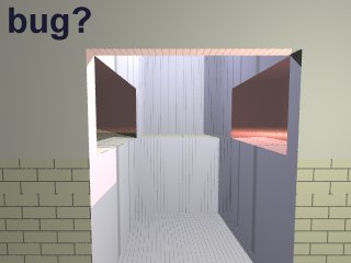

'ello. I mentioned this in the bug reports as well, but if someone in
the general audience :) could tell me if it's bug or feature, I'd
appareciate it.
Anyway, pardon me if my mathematics are insufficient to explain the
problem properly, but....
When doing some DIFFERENCEs where the, um, surfaces of the objects are
in the same plane it cuts a hole INTO the first object. That is, I can
see INTO the the block of the A object as if it were hollowed out with a
big spoon.

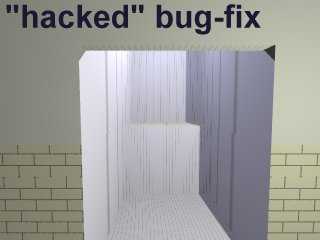

Follows code that shows the prob. It's a house block where I'm
subtracting a stair well. I got around this by the hack of adding .01 to
some of the x coordinates. That works. Looks a little ugly though.
danke,
--min

From: Dan Connelly
Subject: Re: difference problem w/3.1
Date: 3 Oct 1998 18:04:05
Message: <36169144.C71DB716@flash.net>
Differences of coplanar surfaces are not well defined.
Due to the finite precision of floating point operations.
You should always make sure the negative object overlaps
the positive one.
This is a well-known feature of POV, and other renderers,
as well.
Dan

From: Lewis Sellers
Date: 3 Oct 1998 22:27:19
Message: <3616CF06.98333CF0@usit.net>
> the positive one.
> as well.
> Dan
Hmm. That makes life more difficult. :)
So, you're saying that I just have to make sure it overlaps by a small
amount (.001 or so) to fix it. And that's what every does?
That is, in fact btw, how I "hacked" the problem last night after
spending a few frustrating hours tearing apart my house model looking
for the stray object I thought was causing the prob.
Thanks for the info.
You know, a scene directory containing examples of all the "features" of
pov-ray might be useful. If anyone ever makes one, I'll donate my
preceding scene. ;-)
--min

From: Lewis Sellers
Date: 3 Oct 1998 22:56:31
Message: <3616D5D2.731FFDAB@usit.net>
This, btw, is what I was talking about to anyone that was curious.

From: Dan Connelly
Date: 3 Oct 1998 23:14:17
Message: <3616D9F6.90BD4CBB@flash.net>
Nt really -- you get accustomed to it quickly.
Yes.  It can either be an offset or a scaling.  But make
sure it overlaps.
Also on unions where the components have different textures,
you must also avoid coincident surfaces for the same reason.
It's a classic raytracing problem.... as I said, one quickly
gets used to avoiding it.
Dan
http://www.flash.net/~djconnel/

Ah. Still feels a bit messy, but thanks. I guess it's a good thing--my
first encounter with a "classic raytracing problem". I think it deserves
it's own month at IRTC. ;-)
Thanks,
--min

Lewis Sellers <lse### [at] usitnet> wrote:
: So, you're saying that I just have to make sure it overlaps by a small
: amount (.001 or so) to fix it. And that's what every does?
: That is, in fact btw, how I "hacked" the problem last night after
: spending a few frustrating hours tearing apart my house model looking
: for the stray object I thought was causing the prob.
  You talk like it was a bug which you have to avoid by hacking the scene
in some way.
  No, it's not a bug. Povray works perfectly. How do you expect povray to
know which one of the coincident planes is at the most top? You have to
tell it to povray or it can't calculate it. And you tell that by placing
the topmost surface a little higher than the other.
                                                           - Warp. -
