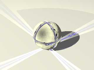

I am currently working on an image where I want some tubes to shine and glow
like neon light. I have added an image to show you the blue tubes I want to
be used as neon lights.
Anyone got a solution for good realistic neon lights? I am currently trying
to accomplish it using multiple lights in the tubes, but that increases the
rendertime bigtime too. Anyone got a better and maybe faster way to do
this?
Kind regards,
NumbC
Download 'test001.jpg' (178 KB)
Preview of image 'test001.jpg'

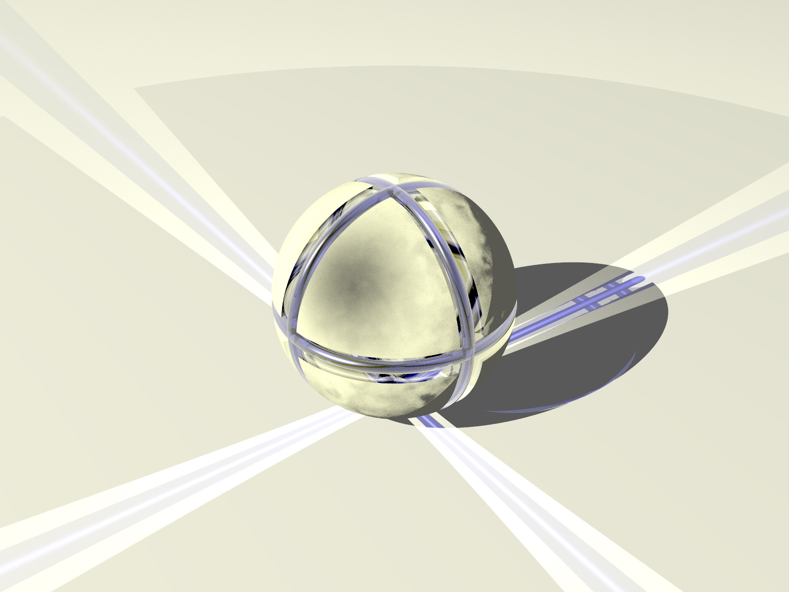

From: s day
Subject: Re: Neon Tubes (Anyone can tell me how to make them emit light)
Date: 8 Sep 2005 08:45:01
Message: <web.432031edfb56d42840d88eb30@news.povray.org>
I would use MegaPov's glow feature. (Used to produce the image below which
is only partially rendered.) This was just a modification to one of the
sample scenes (written by Christoph Hormann) and the tube lights are
generated with the following code:
#version unofficial MegaPov 1.1;
#declare Brightness = 54;
#default {
  texture {
    pigment { color rgb 1.5 }
    finish { diffuse 1 ambient 0.0 }
camera {
  location    <-92, -12, -35>
  direction   z*1.5
  right       1.33333*x
  look_at     <-73, 0.0, 0>
#macro Glow(Color)
  media {
    emission 1
    density {
      cylindrical
      poly_wave 5
      density_map {
        [0 rgb 0]
        [1 rgb Color]
    method 3
#end
#declare ls = union {
  cylinder {
    <0, 0, 0> <0, 10, 0> 1
    hollow on
    pigment { rgbt 1 }
    interior { Glow(<1.0, 1, 1>*Brightness) }
    no_image
  cylinder {
    hollow on
    pigment { rgbt 1 }
    interior { Glow(<0.1, 0.2, 1.0>*Brightness) }
    no_radiosity
  rotate <-90, 0, 0>
  translate <-70, 24, 0>
object { ls rotate <0, -20, 0> }
object { ls rotate <0, 0, 0> }
object { ls rotate <0, 20, 0> }
object { ls rotate <0, 40, 0> }
object { ls rotate <0, 60, 0> }
object { ls rotate <0, 80, 0> }
object { ls rotate <0, 100, 0> }
Of course if you don't want simple shapes (cylinder, sphere box etc.) you
might have a bit more difficulty..
Sean
Download 'glow.jpg' (53 KB)

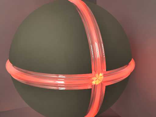

From: Mike Raiford
Date: 8 Sep 2005 09:56:48
Message: <43204320$1@news.povray.org>
I'm with everyone else:
radiosity+emitting media.
It seems your neons are torroidial, so use a torus function, something like:
#declare neon_light =
torus
     2, 0.1
         pigment { color rgbt 1 }
         finish { ambient 4.0 diffuse 0 reflection 0.5}
             hollow
         interior
             media { emission rgb <1, 0.01, 0.001> *15
                 density
                    function { f_torus(x,y,z,2,0.05)}
The radiosity block I used:
     radiosity
        pretrace_start 0.08
        pretrace_end 0.01
        low_error_factor .8
        count 100
        nearest_count 20
        recursion_limit 4
        error_bound 1
        brightness 1
        media on
I'll attached a file of what this will look like. Please excuse me if
the object looks similar. I liked it and wanted to make it look the same
(but makes a darn good demo-scene) :)
Adjust the colors in any way you wish. I chose a more typical red for
the neon.
~Mike
Things! Billions of them!

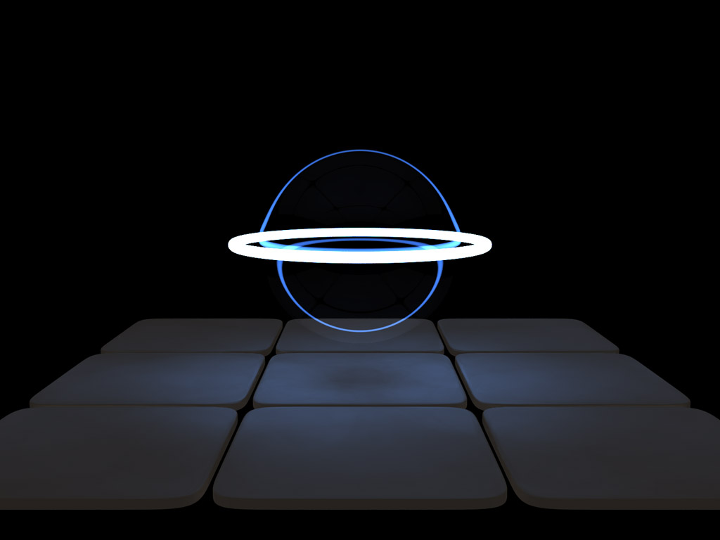

From: NumbC
Date: 9 Sep 2005 06:20:00
Message: <web.432160abfb56d428726bd13c0@news.povray.org>
Thanks for the replies.
I did manage to get a fake sorta glow using emitting media, but I still
can't get the tubes to emit light. The effect I want at this point is to
have no light in the scene and use the tubes to light up.
I will spend this weekend to get better results and post them when I have
something worth showing.

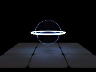

From: NumbC
Date: 9 Sep 2005 10:30:01
Message: <web.43219c41fb56d428726bd13c0@news.povray.org>
Glad you liked it and go ahead and use the idea ;) Love to see your end
result.
I couldn't wait until I got home so I started a new scene during my
lunchbreak at work. I have attached an example render which looks much more
promising than what I got earlier. I placed no lightsources in this scene
so the result is definately what I'm after.
And yes I know ... this sorta thing should be animated (on my to-do list)
LOL
I hope you like it and I will continue experimenting this weekend.
NumbC
Download 'neon test 004.jpg' (68 KB)
Preview of image 'neon test 004.jpg'
