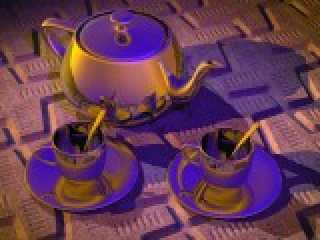

Greetings, POV'ers !
If anyone perhaps has the source for the original old
"KKTEASET" picture that is currently on Povray's home page, would they
please be so kind as to post it, or perhaps mail me ?? I am asking because
I would like to see how the 'ground' texture was done. That rough stone
tiling effect. I think it's excellent, and I would like to do someting
similar for an animation scene I'm working on.
Much appreciated !
Fanx a bunch !
Charl  :)

I finally found this kkteaset.zip. But  in this zip there's the same
image than in the pov's site and a file "kkteaset.s" wich i'm not able
to use. Maybe you'll know how to? whenever you'll be able to use it
or if you find a usable script, let me know.

I can see now what is this kkteaset.s. Really sorry! No script!

I have kkteaset.zip on the povray cd. I looked at "kkteaset.s" which is
nothing more that a jfif image. There is no kkteaset .pov file in that
zip archive.

Thanx for the replies here !  :)
I also have the povray CD, and  I found the same file on there,
zipped with a jpg image.
Unfotunately that brings me right back to square one....
If anybody knows where I can find the source for this image,
I would be real happy. All I want is the ground stone texture source.
I want to do sometnig similar, but with a different design.
I have tried a few heightfields, but I just can't get the effect I want.
Seems to be quite a tricky one this.

If you're thinking about the image I think you're thinking about, then
you've got a problem. The effect you see is due to a bug in POV-Ray's
interpretation of normals (and bump_maps in particular iirc). I think
the bump_map has been fixed at some point of the 3.1 development, but
the general normal bug is still there, thus rendering any attemp to
reproduce the effect with a height_field imposible. I think you just
have to come up with the right bump_map and render it with, say, 3.0.
I might be wrong, though. Life shows I often am :)

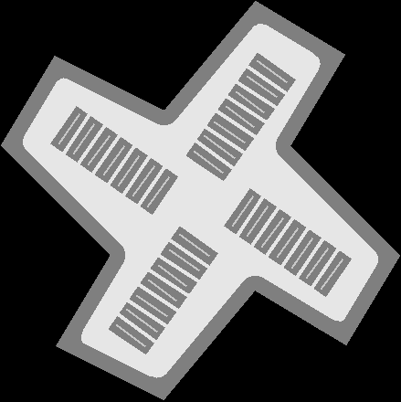

This is a bit modified version of standard texture.
#declare Grnt6 = texture {pigment{
   granite
   turbulence 0.5
   colour_map {
      [0.000 0.153 colour red  0.545  green  0.380  blue  0.345  filter
0.000
      colour red  0.588  green  0.475  blue  0.333  filter  0.000]
      [0.153 0.398 colour red  0.588  green  0.475  blue  0.333  filter
0.000
      colour red  0.675  green  0.478  blue  0.404  filter  0.000]
      [0.398 0.559 colour red  0.675  green  0.478  blue  0.404  filter
0.000
      colour red  0.757  green  0.635  blue  0.522  filter  0.000]
      [0.559 0.729 colour red  0.757  green  0.635  blue  0.522  filter
0.000
      colour red  0.659  green  0.549  blue  0.443  filter  0.000]
      [0.729 1.001 colour red  0.659  green  0.549  blue  0.443  filter
0.000
      colour red  0.545  green  0.380  blue  0.345  filter  0.000]
#declare Grnt10a = texture {pigment{
   granite
   turbulence 0.6
   colour_map {
      [0.000 0.179 colour red  0.843  green  0.655  blue  0.655  filter
0.455
      colour red  0.886  green  0.769  blue  0.627  filter  0.608]
      [0.179 0.368 colour red  0.886  green  0.769  blue  0.627  filter
0.608
      colour red  0.906  green  0.820  blue  0.714  filter  0.392]
      [0.368 0.538 colour red  0.906  green  0.820  blue  0.714  filter
0.392
      colour red  0.851  green  0.671  blue  0.671  filter  0.659]
      [0.538  0.744 colour red  0.851  green  0.671  blue  0.671
filter  0.659
      colour red  0.890  green  0.792  blue  0.675  filter  0.392]
      [0.744 0.983 colour red  0.890  green  0.792  blue  0.675  filter
0.392
      colour red  0.827  green  0.612  blue  0.612  filter  0.706]
      [0.983 1.001 colour red  0.827  green  0.612  blue  0.612  filter
0.706
      colour red  0.843  green  0.655  blue  0.655  filter  0.455]
#declare Stone4 =
texture { Grnt6 scale <1.5,3,2> rotate <0,0,40> finish{diffuse 0.9
ambient 0.02}}
texture { Grnt10a scale <1,3,2> rotate <0,0,-30>}
The tiles are Level Connector http://www.idrive.com/k_k/web/levcon.htm
height fields from this mask.
Some noise was added to the hf to get that nice surface.
K.K.
