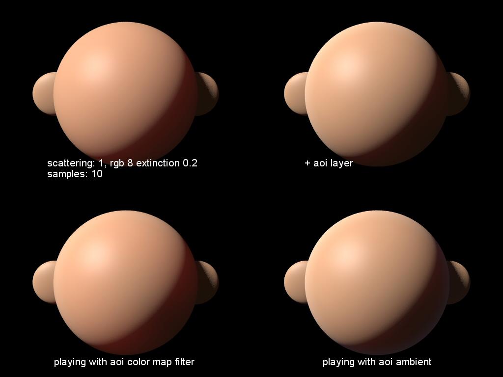

1 - Mixed sss and aoi (mlpov0.83/megapov1.1) : not too bad, I think it's ok.
Aoi is quite helpful, especially when an image map is used as last layer
(the white edge is usually lost).
Script posted in p.b.s-f.

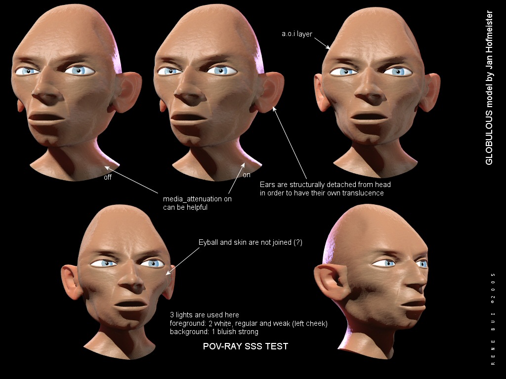

Toying with Globulous (a model by Jan Hofmeister)
Rene

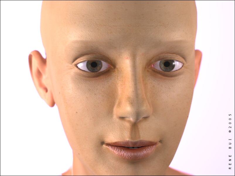

an early Chuck Close-like portrait (sss+aoi)
Rene

Wow, looking very good.
I think the eyes should be a little more shiny, they look a little 'dry' at
first glance.
The lips look pretty good.
There seems to be a line over the cheekbone - was that intentional?
I love the wrinkles around the eye, I assume that's modelled or did you use
a bump map here?
Thanks
>first glance.
You're right, but I was so concentrated on skin problem that I forgot to
work on eyes texture.
Thanks again
hmm.. not really, there is something wrong here with the model (a too flat
area) and unfortunately the light... :(
>a bump map here?
it's a hand-made bump map.
Rene

Very impressive, although some of them look a little 'waxy'.
>   Looks like it's not a bad idea, but I fear the work required to create
> my own skull, and then remodeling the head to fit the same shape...
What about using an image map to do it?
A map would have the advantage of being able to control the effect near
elbows and knees, which would be a little 'thicker'.
Look at the following product:
http://market.renderosity.com/softgood.ez?ViewSoftgood=34302
This is using Poser's renderer, but the same Aoi trick can be (better) used
with POVRay.  I have to admit it's tempting to get the product and see what
the maps he uses look like.
        == John ==
