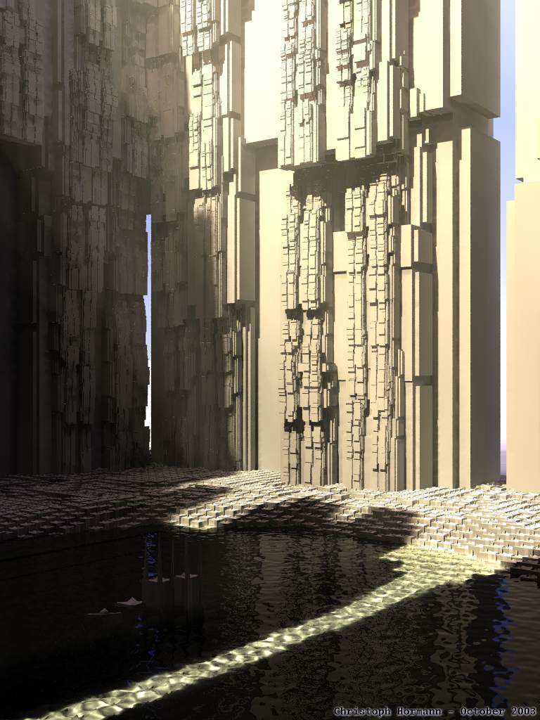

This is the first serious render i did on my new computer - nicely fast,
only a few hours. :-)
I had some troubles with photons and media so i saved the photons
without the media and reused them for the final render.  I will have to
add some scattering to the water as well so the light looks more natural.
Nearly all the geometry (walls and ground) is meshes.  The somewhat
jaggy look on the upper left is due to a combination of radiosity,
media, area_light, aa and jpeg artefacts.  I am still not sure what
causes the straight lines at the left side of the water.

On Wed, 08 Oct 2003 17:08:10 +0200, Christoph Hormann <chr### [at] gmxde>
Water ? I noticed water only because you mentioned it :-)
My perception was somehow focused on bright areas of the scene.
Have a fun with your GHertzes and GBytes.
ABX

In article <rrl### [at] tritonschunteretctu-bsde>,
> Christoph
It is very impressive ! But why did you use meshes to make the walls ?
Wouldn't it be easier with macros scattering boxes ?
Noe
"Je ne deteste que les bourreaux" -- Albert Camus
Pour m'ecrire un mail, veuillez retirer PASDEPUB de mon adresse ;)
Subject: Re: Walls [102k]
Date: 8 Oct 2003 13:12:03
Message: <81td51-egn.ln1@triton.schunter.etc.tu-bs.de>
Thanks.
I wrote a macro generating a box as triangles and used that...
A mesh is almost surely quite a bit faster than using boxes although i
did not compare it here.

I like where this image is going. It has a very spacious feeling to it.
Like ABX, I too did not notice the water until you mentioned it. Will
the water be a key part of this image?
> Christoph
Samuel Benge
stb### [at] hotmailcom
Date: 8 Oct 2003 14:12:02
Message: <7b0e51-85v.ln1@triton.schunter.etc.tu-bs.de>
Thank you.
Probably not if you all fail to see it. ;-)
In fact i first had a version of the ground without it but it looked too
dominant because of the perspective (the camera is quite a dilemma after
all.  I would like less of the ground but moving the camera upward will
result in the walls appearing less 'high' and rotating it upward would
result in non parallel verticals).
Last updated 2 Sep. 2003 _____./\/^>_*_<^\/\.______
I guess it's due to the posted image being too high to fit a typical
user's screen. I had to scroll to see it.
I would leave the perspective as it is now, but I would close the bright
gap on the left (the strong contrast hinders the eye from seeing details
in the dark, which at least for me is visually disturbing), and perhaps
  illuminate the water a bit - but only a tiny little bit, just enough
to make it recognizable as water at first sight.

The image is a good start with lots of potential. The walls remind me of the
interior design work of architects Frank Loyd Wright and Walter Burley
Griffin.
Hopefully someone will create a patch for perspective correction or a camera
type that performs like a traditional wide format "tilt" camera. This would
greatly expand the artistic posibilities of POV.

no13 <pov### [at] no13net> wrote in message
news:web.3f85f6d2e32c7442a0dca75e0@news.povray.org...
camera
would
John Guthkelch (Doctor John) wrote an architectural field camera macro that
works quite well to keep the verticals...
http://news.povray.org/povray.text.scene-files/29463/
RG
There is a different solution prepared for MegaPOV 1.1. It's user-defined
camera which allow cameras of any kind trough functions. See:
http://news.povray.org/search/?s=user_defined
