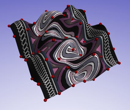

Hi, all pover.
  This is my first contribution.
  I have now made a include file "splines.inc". In this include,
"Bezier_Plane_UV" macro can create a free curved surface by joinig sevral
bicubic_patches of MegaPOV together.  This surface goes through the points
that you need, and you can use UV mapping on this surface.
  You can get this macro in my home page. get and try to use it please.
Than you.
http://yasucg.site.ne.jp/page_e/spline_macros.html
< Yasu.I. >

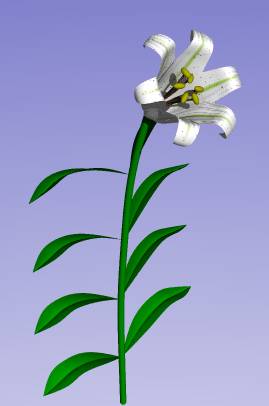

I am now going to plane the new work. I will try to create a flower object
by using this macro insted of using modeller.
I post the new picture.
In  this flower, petal and leaf is created by Bezier_Plane_UV macro, and
stem is created by sphere_sweep object.
Thank you.
<Yasu.I>
