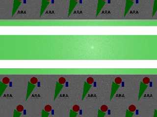

Hi(gh)!
Onward with the standard include files and, thus, with the PoV-Ray
museum of Port Whatmough's Academy of Raytraced Art (ARA)!
When I started to test the neon tubes for the exhibition rooms'
illumination, I noticed a strange behaviour of the area_light: although
I defined center and size of the area light correctly, the light
concentrates in one point! Moreover, the looks_like object (a union of
two narrow cylinders) is cut in half!
Here is the code:
#declare F_Standard_Indoor =
finish
   diffuse 1.15
   brilliance 0.6
#declare F_Incandescent =
finish
   diffuse 1
   ambient 1
#declare T_Simple_White_Incandescent =
texture
   pigment { color rgb 1 }
   finish { F_Incandescent }
#declare Neon_Tube =
cylinder
   0, <2, 0, 0>, 0.025
   texture { T_Simple_White_Incandescent }
   plane
     y, 0
     texture
       pigment { MidnightBlue }
       finish { F_Standard_Indoor }
   light_source
     <1, 0.1, 0.06>
     color White
     area_light
     <2, 0, 0>, <0, 0, 0.12>, 5, 2
     adaptive 1
     jitter
     fade_distance 1
     fade_power 2
     looks_like
       union
	object { Neon_Tube translate <0, 0.1, 0> }
	object { Neon_Tube translate <0, 0.1, 0.12> }
   camera
     location <1, 4, 0.06>
     look_at <1, 0, 0.06>
     angle 40
// end of code
Bizarre!
See you in Khyberspace!
Yadgar
Now playing: Illusions On A Double Dimple (Triumvirat)
Download '2011-12-02 includes showroom 1, take 19 - neon tubes, assembly view.jpg' (13 KB)
Preview of image '2011-12-02 includes showroom 1, take 19 - neon tubes, assembly view.jpg'
From: clipka
Subject: Re: Strange behaviour of area_light
Date: 2 Dec 2011 10:16:11
Message: <4ed8ebbb$1@news.povray.org>
You have two different issues here:
- The historic area_light code is only designed to generate soft
shadows; other effects (highlights and - as in your case -
distance-based light fading) remain as per a standard point light. (The
area_illumination switch introduced with 3.7 does fix this for
highlights, but not for distance fading yet.)
- As for the looks_like object, note that you need to specify that
object as if the light source was located at <0,0,0>; it will
automatically be translated to the true position of the light source. (I
just noticed that this doesn't seem to be mentioned in the docs. I'll
take care of that.)

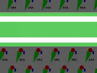

I tried area_illumination (second image attached here) - and, yes, a
little bit grainy, but I think it's tolerable at least for the time
being! The area illumination not being taken into account for fading
might yield weird results, but for my scene it would not very notable,
as I'll use not less than 5 x 6 of these dual neon light panels for a
room of 15 by 12 metres!
> take care of that.)
So the looks_like object is automatically centered around the (center
point of the) light source... would be a good idea to mention this in
the wiki (and the regular doc which comes with the installation package)!
Yadgar
Download '2011-12-02 includes showroom 1, take 20 - neon tubes, assembly view.jpg' (14 KB) Download '2011-12-02 includes showroom 1, take 21 - neon tubes, assembly view.jpg' (18 KB)
Preview of image '2011-12-02 includes showroom 1, take 20 - neon tubes, assembly view.jpg'
Preview of image '2011-12-02 includes showroom 1, take 21 - neon tubes, assembly view.jpg'

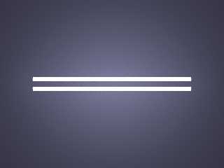

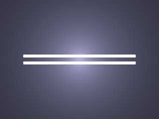

From: Jörg 'Yadgar' Bleimann
Date: 5 Dec 2011 20:52:32
Message: <4edd7560@news.povray.org>
Hi(gh)!
On 02.12.2011 19:31, Warp wrote:
> And the reason why area_illumination is not always on (at least
> currently) is that it makes rendering of area lights a bit slower.
Yes it does... 129.029 CPU seconds (I assume that this is the time
actually devoted to POV-Ray regardless of any multitasking background
processes) (first image) vs. 148.053 for the the last image attached here...
Yadgar
Now playing: East At Easter, live 1987 (Simple Minds)
Download '2011-12-06 includes showroom 1, take 59 - neon light and carpet.jpg' (67 KB) Download '2011-12-06 includes showroom 1, take 60 - neon light and carpet.jpg' (55 KB)
Preview of image '2011-12-06 includes showroom 1, take 59 - neon light and carpet.jpg'
Preview of image '2011-12-06 includes showroom 1, take 60 - neon light and carpet.jpg'
