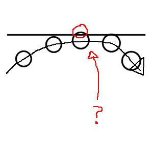

What I was talking about now in more detail:
If you shoot a particle in an angle, and the position calculated
for the particle does just not touch the ceiling, but the radius
of the particle does, how do you do that?
I've attached a crude image that shows what I mean.
Do you do some extra-trace()s and do a rough check of the near
vicinity or what?
Download 'path.jpg' (9 KB)
Preview of image 'path.jpg'

My particle system does indeed only do collision detection using the center
point of the particle as reference. I don't think there's much I can do
about that unfortunately...
Rune

In my animations I use the centre of the particles and its radii to
calculate collisions along its velocity vector.
To avoid the problem you're showing here, I would use four more trace()s
along the same direction but starting from the frontier of the particles
rather than from the centre. You have to cover its envelope along its
velocity direction. I will try this and post the results as soon as I have
some time (I haven't raytraced for four days :-(
Jonathan.

Yes, and even so, it's not very precise. That's why I don't like it.
And in most of the simulations I do, it won't make a difference anyway.
Remember that solid objects is just one out of many uses. For liquids, fire,
smoke, sparks etc. it doesn't matter at all.

No, the direction has to be the same. Think of your particle as a
sphere_sweep: you simply have to trace() from the centre and from some
points of the diameter normal to the velocity direction.
Jonathan.
