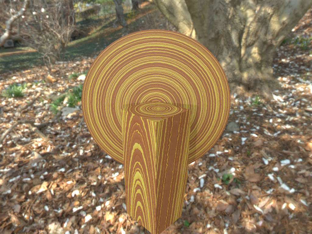

Working through the spiral part of:
http://flycooler.com/download/Wood_SIGAsia2016.pdf
And struggling to understand
1) how the texture actually gets mapped/tiled onto the spiral
and
2) what points then, am I interpolating?
I'm guessing that either the 2D texture get mapped once onto each successive
turn of the spiral,
or it gets mapped linearly onto the nonlinear arc-length of the spiral arms, and
so there are then spaces between the x-dimension points?
Maybe someone could look at this and offer some ideas?
Even if you're just shooting in the dark, whatever you suggest might trigger an
idea for a solution.
Thanks!
- BW

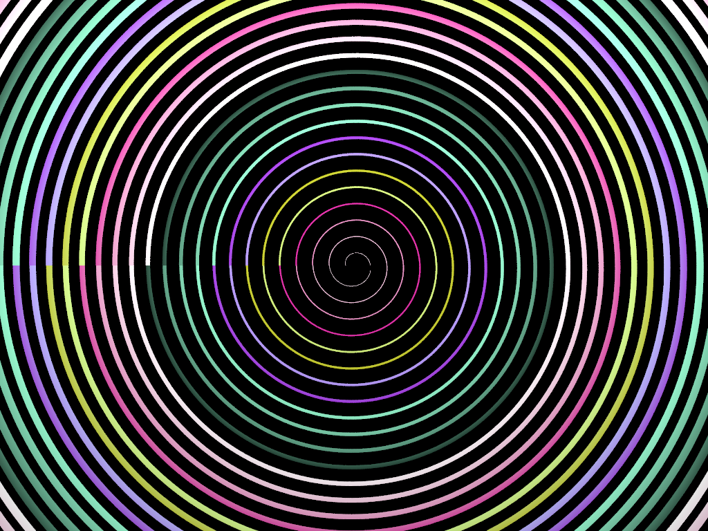

It also seems to me that in addition to knowing if I'm on of off/in-between the
spiral, I'll need to somehow be able to know how far along the arc length of the
spiral I am at any given point.
Varying the r, g, and b values by different multiples of the arc length formula,
and changing the thickness of the lines as a function of arc length gives me the
attached.
- BW
Download 'spiralpattern.png' (439 KB)
Preview of image 'spiralpattern.png'

Trying to work out the "growth rings" part of the the paper, and while the words
sound reasonable, translating that into equations and code is --- less
straightforward.
Thankfully, due to the lessons of the past million projects, I can at least come
up with workable POV-Ray equivalents that serve the same purposes.
At least the pattern looks like wood, although the texture and finish are
obviously not even close - since that will rely heavily on later work.
hdr light probes really change the colors compared to a point light source and
sky_sphere!   :O
At least it looks somewhat like a cheap 4x4 post I might see at a big box store.
- BW
Download 'growthrings.png' (1248 KB)
Preview of image 'growthrings.png'

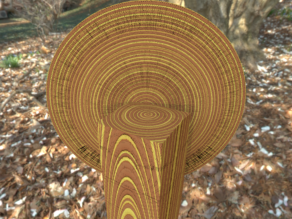

After a few more hours of feeling my way through the math of the patterns I
wanted,  I was able to apply the pores to the wood, and then add the rays.
I only partially know what I'm doing, and don't have very good control over how
all of the parameters in the functions work.
Basically what I'm doing is creating a grid of circles, but radially, using
cylindrical coordinates.
Then it's just adding some randomness and scaling to get the desired effects.
No idea if at this point adding SSLT to the finish would really boost it.
- BW
Download 'growthrings.png' (1480 KB)
