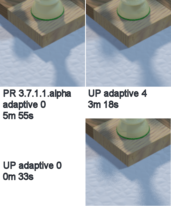

And quality, not to forget that.
UberPOV (current release) can be very fast with subsurface scattering and
area_light, however there's a caveat.
Using all the same scene, other than changing adaptive number for area light,
there's some kind of breakdown in quality of the shadows and SSS.
Here's the image put together from 3 separate renders of a corner of the chess
set scene I've been using with camera blur, radiosity, SSS and 2 area lights
(changed adaptive of both).
Render times shown. Please be aware I resized about 30% larger to make the
differences more visible but still exist at the original size.
Download 'pr3711alpha up sss arealight compared.png' (400 KB)
Preview of image 'pr3711alpha up sss arealight compared.png'

Didn't say a couple things I should have...
The only subsurface scattering object is the lower portion of chess piece. The
chess board is simply wood patterns from sample files.
And the problem I'm seeing with UberPOV area_light is about the unsmooth
shadows, which is as though keyword 'jitter' were used.
Increasing adaptive helps eliminate that but also smears the shadows, and
obviously increases render time.
Again, no changes in things like SSS sampling or anything else is done between
renders.

I can't recreate the problem here -- neither the jitter effect, nor the
difference in the width of the shadow.
I need the scene (ideally trimmed down to the bare minimum showing the
problem).

From: clipka
Subject: Re: arealight speed UberPOV compared P-R 3.7.1.1 alpha
Date: 20 Nov 2016 22:07:07
Message: <583264db$1@news.povray.org>
Am 21.11.2016 um 02:39 schrieb omniverse:
> Found out what makes the change happen. Camera blur messes with both the area
> light and subsurface.
Found the culprit.
The jitter effect is quasi-intentional (it's part of how it speeds up
stuff) and was no surprise for me.
The difference in the shadow falloff, on the other hand, is anything but
intentional, and will be fixed in the next build.
From: omniverse
Date: 20 Nov 2016 22:30:01
Message: <web.5832691ba6150ab59c5d6c810@news.povray.org>
Playing with parameters, I found out what's really making the difference for
UberPOV.
blur_samples min, max
Using only one number instead of two, 20 from maximum in this case, seems to
help smooth out shadow and subsurface dithering.
For render times are much shorter using UberPOV, except to get similar image
quality I still had to use adaptive 2 for the area lights.
And in doing that I discovered the render times to be equivalent if POV-Ray
3.7.0 official is set to adaptive 0. So this means same or very similar quality
for same render times.
Main thing being that UberPOV might be able to prove faster, albeit at some
expense of quality.
I haven't tried a variety of different settings for blur_samples and subsurface
samples so there's still some question as to which might be best for both
quality and speed.
I hope you can find something out about how area_light and camera blur might be
conflicting.
From: omniverse
Date: 20 Nov 2016 22:35:01
Message: <web.58326a51a6150ab59c5d6c810@news.povray.org>
> Found the culprit.
Encouraging to hear. Posted what else I was finding from scene file changes, as
you will have seen before this.
Maybe if area light adaptive can be reduced from 2 to 1, possibly 0, that could
mean much faster render times versus official POV-Ray 3.7 and still retain
quality.
I'm going to hope so anyhow, and much good luck to you regardless of the
outcome.
