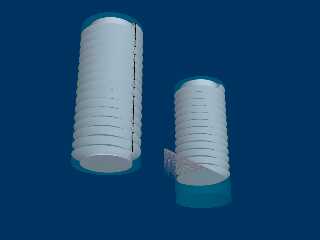

Hi,
In the attached image (this is a view from below).
In the center, the object built from the union of a cylinder and a mesh.
On the right, the same object “cut” at the base by a plane
difference {
  object { Screw }
  plane { y,0 }
And then, as you can see, something “weird” happens.
If I make the difference with a box, it's the same thing.
And, if instead of “cutting” at the bottom, I cut at the top, the same
thing happens. It can't be a problem of surface coincidence. The values
are quite different, in fact.
Do you have any ideas for solving this issue ?
nb: the vertical black line with the balls is simply  gauge to check the
screw pitch and has nothing to do with the problem.

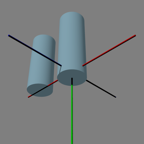

I tried a simple cylinder scene and things look OK test one each of the
v3.7 and v3.8 compiles I have in hand.
#declare Cyl00 = cylinder {
     <0,-0.1,0>, <0,1,0>, 0.2
     pigment { rgb <0.3,0.5,0.6> }
     finish { emission 0.2 }
difference {
   object { Cyl00 translate <-0.7,0,0> }
   plane { y,0 }
   cutaway_textures
object { Cyl00 }
Bill P.
Download 'tmp38.png' (28 KB)
Preview of image 'tmp38.png'

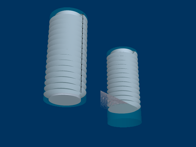

I made others tests. The base object ranges from -1 to 31.
If I try with another y value (say 5) i get the same issue at y = 5.0
has you can see.
I also added the cylinder object limits.
I'm still trying to figure out what's so special about this mesh ...

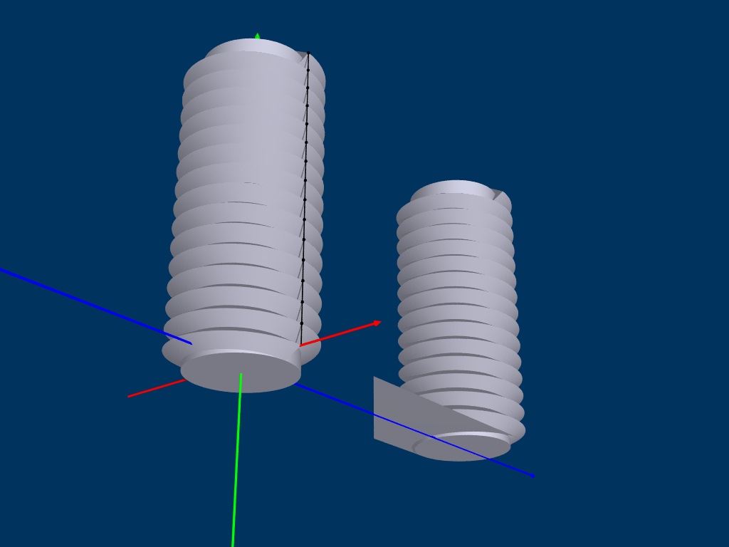

Here, the same things rendered with yuqk* :(
* : look in p.b.programming. I have strange errors with yuqk
kurtz le pirate

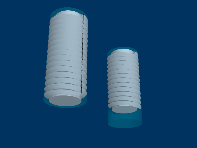

I rebuilt yuqk with the right option (THANKS Jr).
I went back to my 3.8 source code, added the right lines for version
3.8.0-x.yuqk_a5c25dda and re-rendered. As expected, the names of my
variables are accepted without any problem.
I'm happy.
Attached is a summary of this "magnificent" scene.
Do you see the problem ?
The issue I mentioned earlier has disappeared !
What is the relationship between the "--disable-no-lc-identifiers" and
the difference  { } opération ?
A new leap into the 5th dimension :(
kurtz le pirate
