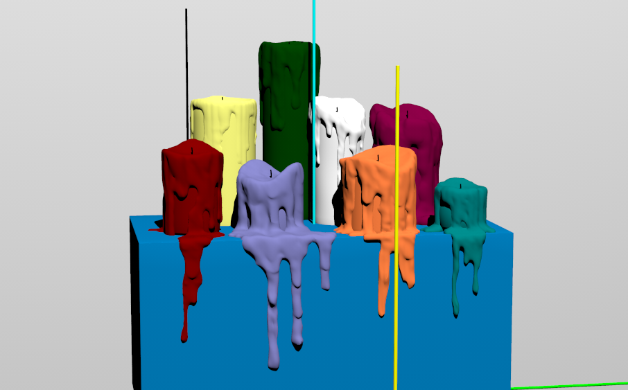

> it /seems/ to be with how the object was built.
well now i'm not so sure about that anymore ... curious i did some
slightly more than casual tests. i'm starting to think it's how poseray
is exporting or how povray is parsing. the images are appropriately
output from poseray.

From: Stephen
Subject: Re: Continuing Blender-PovRay discussion
Date: 28 May 2013 09:03:00
Message: <51a4ab04$1@news.povray.org>
On 28/05/2013 1:47 PM, James Holsenback wrote:
It's not something silly like PoseRay's default export handiness is
Right handiness?
I generally only export the geometry and change the handiness to Left
handiness (PovRay default).
Regards
     Stephen
