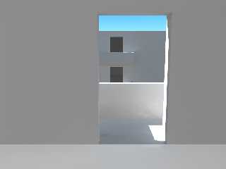

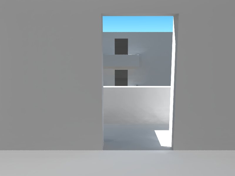

Attached you see what I got now... as far as the overall brightness
level are concerned, I'm satisfied now; but currently, the brightness
distribution looks as if the room entirely is lit by artificial light,
regardless of the sunlight outside. Therefore, I would like to try a
wide-angled spotlight sitting in the middle of the door opening instead,
as the light should enter the room from outside the door!

Download '2008-08-05 my place on earth (altena version) wip, take 24 - street view,using light_groups, rgb 0.2, indoor brilliance' (20 KB) Download '2008-08-05 my place on earth (altena version) wip, take 22 - view into myapartment, using light_groups, rgb 0.2, brillia' (9 KB) Download '2008-08-05 my place on earth (altena version) wip, take 23 - inside my apartment,looking out, using light_groups, rgb 0.' (14 KB)
Preview of image '2008-08-05 my place on earth (altena version) wip, take 24 - street view,using light_groups, rgb 0.2, indoor brilliance'
Preview of image '2008-08-05 my place on earth (altena version) wip, take 22 - view into myapartment, using light_groups, rgb 0.2, brillia'
Preview of image '2008-08-05 my place on earth (altena version) wip, take 23 - inside my apartment,looking out, using light_groups, rgb 0.'

GWG_FrKarl_Block238to252_Floor_Height + 1.27, 2.43>/f
                color rgb 0.25
                spotlight
                point_at <11.08,  GWG_FrKarl_Block238to252_Floor_yOffset
+ a * GWG_FrKarl_Block238to252_Floor_Height + 1.27, 2.43>/f
                radius 89.9999
                falloff 89.9999
                shadowless
              object
                GWG_FrKarl_Block238to252_Floor_Cutout
                scale 1/f
                translate <0.37, GWG_FrKarl_Block238to252_Floor_yOffset +
a * GWG_FrKarl_Block238to252_Floor_Height, 0.37>/f
              global_lights on
...still the distribution of brightness on the inside wall is very
uniform, such as the room was in fact lit by artificial light
overshining the indirect illumination, although I used global_lights
on... perhaps I should try a smaller radius for the spotlight? Or
introducing some fade_distance/fade_power?
See you in Khyberspace!
Yadgar
Download '2008-08-05 my place on earth (altena version) wip, take 27 - inside my apartment,looking out, using light_groups with sp' (14 KB)
Preview of image '2008-08-05 my place on earth (altena version) wip, take 27 - inside my apartment,looking out, using light_groups with sp'
