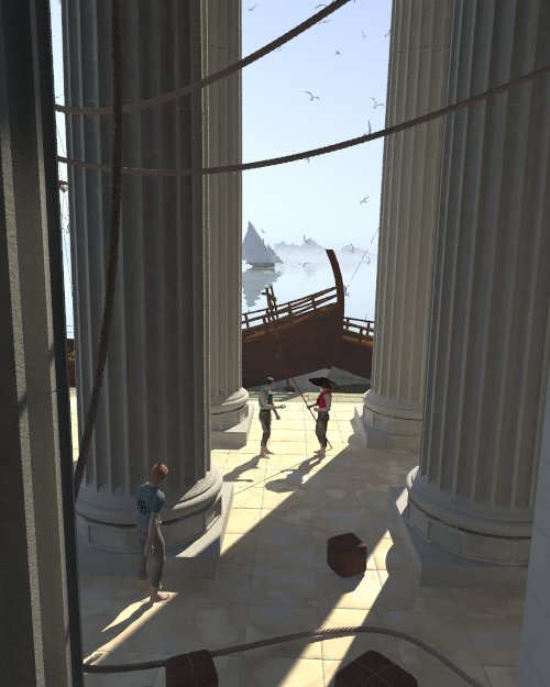

I need your expert comments :-)
This is the first serious render of the scene with radiosity. It is a 2-pass
job (first gathering radiosity data on an image half the size of this one;
took about 5+ hours; second pass was just about 45 minutes). There are still
ugly artifacts visible, especially on the columns. What is the best way to
go from here? I include the radiosity settings used so far. Normal and media
are off; Megapov settings were used
Thanks for the help!!

Is that texturing you added to the columns and tiles or is that the
artifacting?  If it is, it almost looks like a nice texture.  ;)
Typically I drop the recursion limit down to 1 or 2 and jack the count
setting way up.  Although a significant portion of your image is in the
shadow, and with the nooks and crannies in the architecture you are
using, keeping it at 3 is probably best.  You might want to try 2 and
see if you can get away with it.  The reason you'd want to lower it is
to save time, because your count is way too low.  I'd bump up to 1000 at
least, and at a recursion limit of 3 thats going to take forever.
The biggest factor here might be your error bound.  A value of 0.1 is
very accurate and requires a very high count (and ages to render).
Maxing out at 1600 you are still going to see artifacts probably.  I'd
raise that up to at least 0.5 and you might want to go all the way to 1.
  Your lighting won't be as accurate but it will be much smoother.
Remember, as your error bound lowers, the count has to go up.
Nearest count could also be increased to take a few artifacts out.
Skip
Well, what I usually do when using the two-pass method, is to use a
lower error_bound on the first pass, and double or quadruple (always 2
with an exponent attached) the error_bound on the loading pass. What
this does is average more of the samples together, in effect smoothening
the radiosity results somewhat. Of course this leads to loss of details,
but detailed errors are smoothened away as well. You could have a look
at my website as well, I've experimented a little with radiosity some
time back:
http://www.nolights.de/projects/radiosity/radiosity.html
Hope that helps, even if just a little.
Tim
I don't understand your use of the MegaPOV adaptive error_bound - if you
use it in the first pass you will loose control over the accuracy of the
radiosity data taken and stored.  Furthermore using tighter settings in
the final pass will increase the number of samples taken there (and
using always_sample off at the same time could lead to low quality).
I would try to decrease recursion_limit to 2 and use the saved time to
improve quality if that does not change the appearance too much.

Yes, a good question Skip and Steve! I am not sure what it is. I use an
averaged texture for the columns and I think that partly it is texture what
you see. But only partly. I suspect them to be mostly artifacts because the
texture without any radiosity or fancy adds looks much smoother, especially
at the middle distance.
>      I actually see this image as an improvement on the last one. It looks
> good to me.
Thank you Steve! I thought so too. I always try to put radiosity in because
the look becomes more natural. However, the render times and the tuning of
it is really arduous in my experience.
> the final pass will increase the number of samples taken there (and using
Thanks Christoph! I had not realised the consequences of the adaptive
error_bound in the first pass. Quite simply I thought it would - at the same
time - speed up calculations and increase accuracy! Well well well... Things
are never as simple as one believes...

understand what I am doing especially by studying what others have done,
however with radiosity this is not always easy.
Subject: Re: Eavesdropping WIP - radiosity issues
Date: 15 Sep 2006 03:42:29
Message: <450a5965$1@news.povray.org>
"St." <dot### [at] dotcom> schreef in bericht news:4509911a@news.povray.org...
>    That's what I wanted to say! Really, I admire Thomas' work, but I too
> have no experience with Rad, and consequently, don't know what an
> 'artifact' is. When they're spoken of, I always find it hard to see what
> the author is seeing.
I did not answer fully your comment. Sorry for that.
Apart from the column shafts, you can see those black spots towards the
base, on the horizontal surface just below the torus. Those are definitely
artefacts. So, although I feel not happy about the shafts, the image is
almost there.

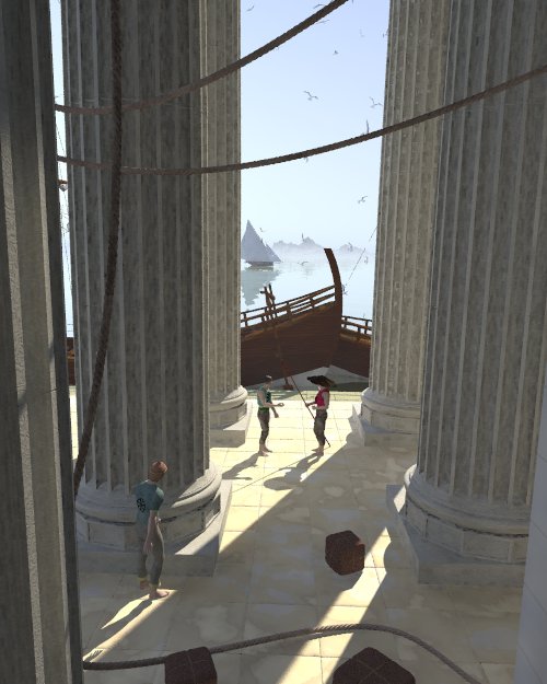

Subject: Re: Eavesdropping WIP 07 - better radiosity
Date: 15 Sep 2006 11:06:27
Message: <450ac173@news.povray.org>
This is almost 'perfect' :-)
Still a bit of artifacts visible, but not much.
Essentially, what I have changed since the preceding render are:
increasing nearest_count to 10
increasing error_bound at 0.5 in the first pass
increasing low_error_factor to 0.9
increasing count to 250
decreasing recursion_limit to 2
decreasing brightness to 0.8 in the second pass
...and I gained a couple of hours at the first pass! So I can use that to
increase count even more.
Again, many thanks to all for your very helpful comments!!
People! listen carefully to your betters!!!  :-)
Download 'Eavesdropping_wip07.jpg' (52 KB)
Preview of image 'Eavesdropping_wip07.jpg'
From: St
Date: 15 Sep 2006 13:39:59
Message: <450ae56f$1@news.povray.org>
"Thomas de Groot" <t.d### [at] internlnet> wrote in message
news:450ac173@news.povray.org...
    Agreed. This is looking much better! And yes, I now see where the
artefacts were.  ;)
     But, you've got to do something about that texture (on the lower
pillars), because it looked SO good in your other image! Perhaps some kind
of procedural crackle might do it? (Not sure).
       ~Steve~
Date: 15 Sep 2006 15:00:03
Message: <eeesuu$npn$1@chho.imagico.de>
It looks much better (although difficult to judge at this small size)
but under the aspect of the argument i gave concerning the adaptive
error_bound using a higher one in the pretrace than in the final trace
is counterproductive.  Of course the adaptation will automatically
increase it in the final pass but this will make it slower than
necessary.  If you set the starting value of the adaptation to the same
as in the pretrace this will probably make it quite a bit faster and not
much worse (although it is difficult to say for sure). Since there have
not been a lot of tests made with the adaptive error_bound it might be
interesting to see the (non-jpeg-compressed) results of this in
comparison.   If you could quote the number of samples taken in pretrace
and in the final pass that would also help to say if these assumptions
are correct.
Date: 16 Sep 2006 04:07:36
Message: <450bb0c8$1@news.povray.org>
"St." <dot### [at] dotcom> schreef in bericht news:450ae56f$1@news.povray.org...
Steve, I am not sure I get your meaning. The texture is not looking so much
different from the non-radiosity image I believe. There is already a (agate)
turbulence/normal controlling the layered, averaged texture (visible on the
closest pillar to the left). Towards the middle distance this becomes
necessarily less visible. The same would hold for a crackle (for instance),
so you would not really see it. And then, radiosity is also playing its part
here.
Date: 16 Sep 2006 04:27:06
Message: <450bb55a$1@news.povray.org>
"Christoph Hormann" <chr### [at] gmxde> schreef in bericht
news:eeesuu$npn$1@chho.imagico.de...
> It looks much better (although difficult to judge at this small size) but
> error_bound using a higher one in the pretrace than in the final trace is
> counterproductive.  Of course the adaptation will automatically increase
> it in the final pass but this will make it slower than necessary.  If you
> set the starting value of the adaptation to the same as in the pretrace
> this will probably make it quite a bit faster and not much worse (although
> it is difficult to say for sure). Since there have not been a lot of tests
> made with the adaptive error_bound it might be interesting to see the
> (non-jpeg-compressed) results of this in comparison.   If you could quote
> the number of samples taken in pretrace and in the final pass that would
> also help to say if these assumptions are correct.
Thanks Christoph. I much appreciate your comments as I feel that I still
have a lot to learn about this matter. Forgive me if I seem obtuse, but I
find this a difficult matter to understand, despite the excellent tutorials,
by the way, of you and others.
Let's see if I get this correctly.
Concerning error_bound, what I should do is (for instance):
error_bound 0.5 //first pass
error_bound {0.5 adaptive 1.5, 20} //second pass
OK? The quality of the results might then dictate using 0.5 or lower (or
higher, to see where acceptable boundaries are).
My initial assumption was that by making error_bound adaptive (at least in
the final pass) megapov would determine automatically what the necessary
values were, thus gaining time and quality.
I saved the message files fortunately. These are the number of samples taken
during pretrace:
Radiosity samples calculated:           424116 (1.34 %)
Radiosity samples reused:             31208079
  Samples (final trace)                  59336
  Samples (recursion 1)                  78012
  Samples (recursion 2)                 346104
And these of the samples taken during the second pass:
Radiosity samples calculated:            65094 (1.16 %)
Radiosity samples reused:              5549135

With the changes to error_bound, I shall make a new render and post both
images (the present one and the new one) together in png format.

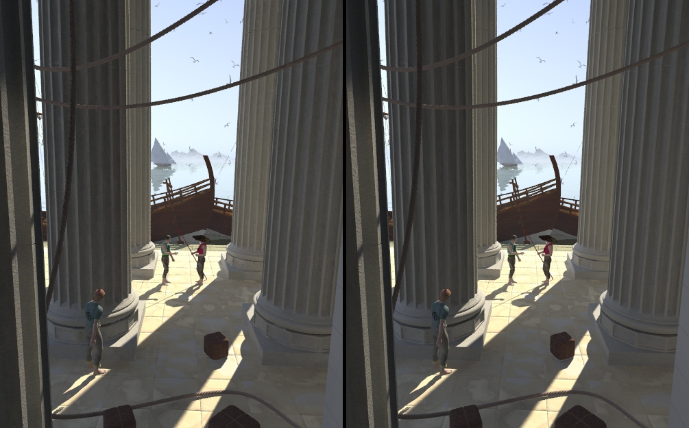

This is a test with the two settings for error_bound, all other settings
being equal. The images here are uncompressed jpg.
the image to the left, is the original one, with:
error_bound {0.1 adaptive 1.5, 20} //second pass
The image to the right has the settings:
samples for this image were:
Radiosity samples calculated:             1124 (0.03 %)
Radiosity samples reused:              3571781
  Samples (final trace)                   1124
  Samples (recursion 1)                    188
  Samples (recursion 2)                    936
and render time about 20 minutes.
The image to the right is the better of the two IMO.

From: Tim Attwood
Subject: Re: Eavesdropping WIP 07 - Testing error_bound settings
Date: 16 Sep 2006 08:44:47
Message: <450bf1bf$1@news.povray.org>
I like your image, but I find one thing odd...
the eavesdropper is looking almost directly
into the sun.
Date: 16 Sep 2006 08:50:49
Message: <450bf329$1@news.povray.org>
"Tim Attwood" <tim### [at] comcastnet> schreef in bericht
news:450bf1bf$1@news.povray.org...
> into the sun.
Yes, well he could not choose his spot obviously :-) Must certainly be
unconfortable, to say the least...
