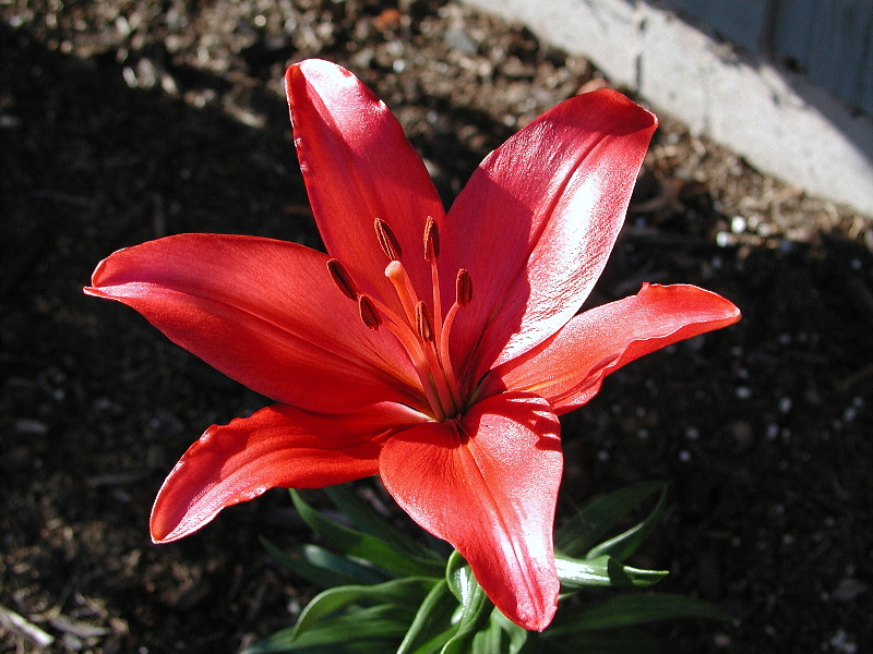

From: Jim Holsenback
Subject: Re: Flower study WIP 01
Date: 15 Apr 2006 07:15:02
Message: <4440d5b6@news.povray.org>
Here's a photo of a Day Lily growing (last year) in my front yard ....
Download 'Day Lily Red.JPG' (228 KB)
Preview of image 'Day Lily Red.JPG'
