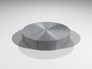

Attached is a jpg of part of a simple scene I am doing that involves
metal textures. At present, the render is taking _far_ too long, because
to avoid aliasing errors, I've had to use sampling method 2 at a depth
of 5. The texture is as follows...
texture
        pigment
                colour rgb <0.72,0.728,0.744>
        normal
                spiral1
                1
                frequency 25
                bump_size 0.33
                accuracy 0.0008
                rotate <90,0,0>
        finish
                ambient 0.05
                diffuse 0.95
                specular 0.96
                roughness 0.0005
                phong 0.43
                phong_size 25
                brilliance 3.15
                reflection 0.33
                reflect_metallic
                metallic on
Is there a quicker way to achieve similar results, specifically, with
the normal to get the spiralling effect?
MJL

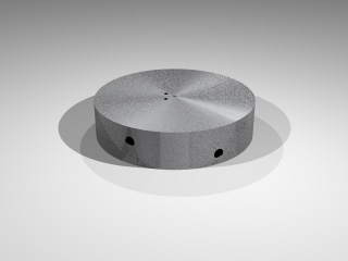

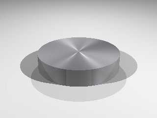

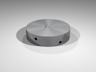

Thanks Rune. I thought of using wood or onion, but the good thing about spiral
is that in addition to giving the nice radial pattern on the face of the metal
cylinder, it _also_ gives fine grooves along the length of the metal cylinder.
Have a look at machined metal cylinders and you'll notice them. They are
responsible for some nice highlights along the length of a metal cylinder, and
using spiral, POV can simulate these to a much greater extent than wood (I don't
know about onion, but I might place a bet on "probably not").  I've attached two
pics of the different effects. The tex is the same as I posted before for
spiral, and wood is very similar (replace spiral1 with wood, and up the
frequency a bit (~*1.25) to get a similar pattern). Note the different effects
on the length of the cylinder, and the way AA depth of 3 (chosen for speed) adds
alot of artefacts.
Could you please give a quick example of the averaging of normals method? I
don't quite follow.
MJL

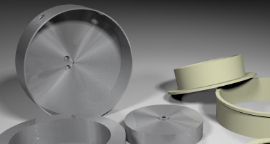

Yes, that's an advantage. With my method you have to use different textures
for the "faces" and the "lengths".
> normals method? I don't quite follow.
I had forgot some details about my method - it's a bit more complicated. You
average whole textures instead.
The attached image was rendered without AA at all, and it took 25 seconds to
render. The effect is a bit different than yours, but it might work for you
with some modifications.
If you're still interested, I can post the code of you like.
Greetings,
Rune
