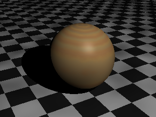

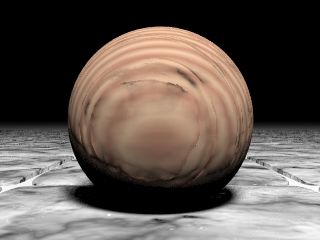

Just tinkering with photo-realism, wanted to see what people thought as to
what could be improved.
This image is NOT that exciting for content though :) I'm looking at the
light/camera settings for maximum realism.
This image uses focal blur of 0.3, an area light, and standard level 5
radiosity settings.
And this image took 6.5 hours for my P133 :(
Download 'camtestf.jpg' (34 KB)
Preview of image 'camtestf.jpg'
From: Johannes Hubert
Subject: Re: Realism Test
Date: 10 Apr 1999 09:33:25
Message: <370f4515.0@news.povray.org>
For real realism, I suggest cylinders with bevelled/rounded edges. Some
scratches (ever so faint) would help too (that goes for all surfaces,
actually - especially the wood could use some roughening).
Even though it is quite possible to create totally polished and smooth
marble, stone and wood cylinders (with razor-sharp edges) and spheres in
reality, the illusion of photo-realism is much more believable if the
objects are *not* that perfect. Mind: They don't have to look weathered.
Just that little tiny touch of imperfection that is hardly visible to the
eye, but gets recognized subconciously.
Is the image supposed to be so dark? It looks a little bit washed-out into
the grey direction.
Also I don't get the bright globe at the top. I guess it is some kind of
lamp? Is it so blurry because of the focal blur or did you use media?
So long,
Johannes.
Good idea. How do you model this however? Rounding/bevelling I can see, but
the scratches? Altering the texture somehow? I can see making the surface
normal vary according to some pattern ( large scale agate? ), but that's not
scatches.
Hmm - I wasn't looking at the models at all in this image, just the
camera/lighting - but you have a good point, yes.
>the grey direction.
It's not supposed to be so dark, no - but the wash out occurs with the focal
blur, and I've corrected it with resetting the assumed_gamma, which just
changes the color of the wash out I guess.
It's the light source, yes, an area light with a looks_like { sphere ..... }
statement. As for the blur, that is only due to the focal blur.
>So long,
>Johannes.
Thanks for your input :)

From: Chris Maryan
Date: 10 Apr 1999 14:14:23
Message: <370F87D6.FE72B4E8@geocities.com>
Camera settings are not where realism fails in most images, neither is
radiosity or lighting. I have followed almost every image posted here
and in the IRTC and the one thing that always bothers me is textures. If
you want to improve realism, consider spending time on getting the
phong/specular highlights, the diffuse and ambient settings right. For
example, in your image, you might consider playing around with the
settings to improve the depth shown by the shading, your spheres look
rather flat. This would probably be best remedied by decreasing the
ambient. Also consider increasing the brightness of the highlights in
your textures. Everything else falls into place naturally once you have
the textures looking right. What you have is an excellent start, keep up
the good work.

Hmmm - any better?
Download 'camtestb.jpg' (11 KB)
Preview of image 'camtestb.jpg'
From: Chris Maryan
Date: 10 Apr 1999 20:54:07
Message: <370FE56F.B83EA129@geocities.com>
Slight improvement with the brightness. I think your diffuse and
brilliance might be too high, try the default settings of 0.6 and 1.0
respectively, as for ambient, I find the default of 0.1 to be
unrealistically low for typical situations, try 0.2-0.3. One of the
problems seems to be the contrast between the bright and dark parts of
the image, raising the ambient should fix this. In the example below, a
subtle highlight really helps the texture (after all, most wood surfaces
have some degree of polish), look at the specular and roughness
settings.
I fiddled around with something similar and came up with the attached
code. Sorry, jpg, just png, I all my conversion programs seem to be
crashing lately. Mine might be a little too dark. This is the code for
the wood (based on one of the textures in the Moray library, I added the
finish settings):
BTW: Anyone know why the background is patchy in the attached .png? It
seems to happen very often in my images.
