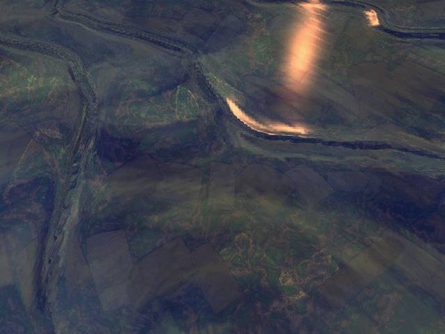

I used a random, though somewhat predefined method of placing bricks on a
plane. Then I created a box with a silty media and topped by a height_field
with the properties of water (I even used irid).
You can see the little artifacts on the water surface. I haven't gone back
and tried any fixes. Would there be any benefit of outputting an hf_gray_16
rendering to a 48-bit png? I just haven't tried it, or anything else.
GrimDude
vos### [at] arkansasnet
Download 'BrikWatr.jpg' (30 KB)
Preview of image 'BrikWatr.jpg'

I'm just guessing here but it appears you are seeing the
grid sections of the height field. You might reduce the
artifacts by using a larger image for the height field.
A larger image provides more grid squares per pov unit.
What size image was used for the HF ? Just curious.
Ken Tyler
>Ken Tyler
I think I used 640x480. I did this about six months ago (heh). I just pulled
this frame out of the flh. BTW, a 33 frame flh of this animation was 17Megs
at 640x480x32768 resolution.
GrimDude

Just to say I like the image, and I agree with ken, the larger->the better -> the more
memory it takes ....

Ken might have nailed it, it does seem to be the grids of the HF... so
bigger image, or move the camera back further... play with scale, maybe?
Or, import into Leveler and try Smooth a few times... <shrug>
Looks nice :)

Use the biggest res hf you can.
Did you use the smooth keyword for your hf?
No 48 bit won't help, 16 bit greyscale is the best you can get.
BTW. Cool pic, I like it a lot :)
Cheers, PoD.
