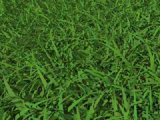

Attached is a sample of grass I cooked up. It's built from smaller squares
rotated randomly to create this patch. I tried a larger size but my computer
(64Mb) refused to swallow it on account of the memory it needed. I'll try it on
another system, but the limitations are already obvious. I don't really
understand this, but I'll do some experimenting.

Pretty good. How long did it take to render and what kind of machine was it?

Nicest grass yet, as most real grass lays down, instead of standing up perfectly...
Only problem is that you can see the lines of grass, so it looks like planted sods,
rather than settled natural grass....

A good grass example, I've seen and made far worse..
But... isn't grass a bit more glossy ????? Just thinking, depends on the sort, of
course..
There seems to eb a bit too much regularity in this one(lines). and I don't think It'd
look that great in a distance..
Perhaps if you scaled all the plants a bit in a random way ?? and then placing them in
a
spiral pattern, should be possible.... and it'd remove some of the lines, and instead
add
others ;-)
//Spider

The image posted previously was a small patch of grass tiled to file a larger
area. I rotated the grass at random, but still there seems to be some sort of
pattern. I saw that and don't know what is causing it. Anyway, you could easily
avoid this in more then one way. The most simple way is to translate each line
of patches a little bit. The code is not a macro (yet) but all parameters are
variables that define the length and width of the patch. So, you could, for
instance make a larger patch. I don't know how this would affect the amount of
required memory (I thought at first that the patch would be declared once, and
after that you only needed some pointers for each time you use it, but this
obviously isn't the case - but that's more something for the
preogramming-newsgroup).

The previously posted image took 15 seconds to parse and about five hours to
render.

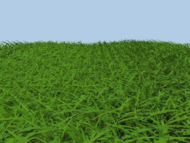

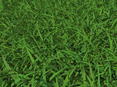

I've attached a new image, which is a close-up of one larger patch, which took 3
minutes to parse and 3:20 hours to render.
I also just finished a new 'pasture' with about 50 patches which took 31 minutes
to parse and 7 hours to render (109Mb peak memory usage).
This all on a Pentium 266 with 64M, so there's room for improvement there.

A couple of ideas to get rid of the lines/regularity. First, declare several
different patches and then use them randomly. Create several patches that
are only half as dense as you require, then when you tile them, overlap by
50%. Again choosing random pairs will get rid of the pattern. Finally, if
you declare your patches as being only 25% as dense as you want, then
overlap by 75 % and rotate them around the vertical axis a random amount,
the edges prety much disappear.
Good luck on this, I have been playing with this for a year or so off and
on. The largest "field" I have done is a kilometre square. This was a field
of wheat with plants spaced 10 cms apart and 8 - 10 blades per plant. That
is a LOT of triangles.
Regards
Gordon

Thanks, for the comments. I think overlapping is a good way to get even more
randomness in the grass. I was aiming for a low-memory sort of grass, but missed
at that.
> at that.
> Remco

Bob Hughes wrote:
> The grass is always greener on the other side of POV ;)
> Seems no ones ever satisfied, last several grasses I've seen looked okay
> enough. About that grooving in the patch (or is it several individual
> patches?), maybe it's a result of a limited range of shifting, either
> rotation or translation, you've used. Even if random then it would still
> be patterned to those constraints. Think so? Or no...
Probably, which makes it a 'groovy grass'.
Remco
