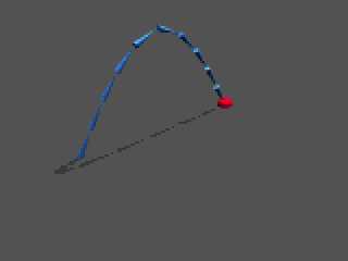

Just thought I'd share my thoughts on leg simulation:
I have tried to do a full inverse kinematic simulation in pov-ray - not
suprisingly, it didn't succeed very well. Professional IK algorithms have
quite complex methods to use up the free degrees of freedom in a 'sensible'
way, which would be quite hard/slow to implement in pov-ray script.
An approximation I thought of is that rarely does the motion of the leg
while it's in the air have to be absolutely accurately controlled. If
vertical movement is ignored, the problem is then reduced to a 2D one. The
next simplification was that for most legs, one degree of movement is only
available at the 'hip' - e.g. in our own legs, sideways movement can only
occur at the hip. A simple rotation of the leg about the hip can therefore
be done to convert it into a 1D problem. An appropriate curve (e.g. a
parabola) of the correct length can be found analytically. See attached for
an example.
The height can then be controlled approximately by just adding a small
amount to the angle of each joint. This works best with many-segmented legs,
so Guenter's method may well be best for his particular application.
-Chris

Hi Chris,
I broke this problem up into two pieces.  The first one is a macro that
determines the exact location of the foot for each clock tick.  The second
macro determines the locations of the joints.  You're right,  the exact
location of the foot during a step forward does not need to be very accurite
in height.  I just used a sin function.  The two segment macro determines
the joint location via a 2D formula.  The three segment macro determine the
joint locations by sweeping the angles and trial and error.  Using this
method I get two degrees of motion at the hip and 1 degree per joint..
Thanks for the input.
