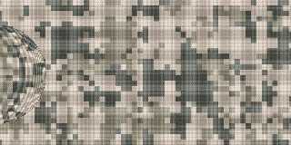

Thanks for the suggestion! If I used your code correctly (had to make a couple
adjustments) then the results are a very nice traditional-looking camo pattern
(render attached). What I'm attempting is the trendy pixelated "digital" style
camo pattern similar to Marine Pattern (MARPAT) or Universal Camouflage Pattern
(UCP). These patterns are generated using fractal functions in order to maintain
the similar pattern appearance at short and far distances. I find that this is
well beyond my ability! I have been reading about camouflage design and it's
very interesting and scientific, but requires more math skill than I possess.
Dave Blandston

Using the checker pigment sounds promising to get the pixelated appearance but
the color_map code generates an error. The POVRay documentation explains "You
may use color_map with any patterns except brick, checker, hexagon, object and
image_map." Darn!
What I'm searching for is a function (fractal in nature) that accepts an (x, y)
location as input and returns a color index value. After researching further it

I have decided to cheat by extracting the color index values from a photo of
digital camouflage. This will guarantee accurate reproduction of the camouflage
pattern even though I am unable to do so algorithmically.
Thanks for the suggestions. I have used camouflage in various scenes over the
years and your first camo code is very unique and useful.
Dave Blandston

Indeed - I looked up "digital camouflage"  and "camouflage algorithm" and got a
lot of hits on Guy Cramer and HyperStealth.
My thought was to use crackle on top of crackle, although maybe what you might
try is using crackle as a base pigment to scan with eval_pigment(), and then
overlay a randomized / turbulent cells or other blocky pattern "on top" of that.
I didn't have time to code anything up, but I'd say it's something that would
need to be iterative, rather than a straight-through one-time function evaluated
based on <x, y>

Yes, I believe the function would need to be iterative in order to produce a
fractal pattern. Apparently one of the goals in camouflage design is to create a
pattern that works at a range of distances. You can see that this actually works
by reducing the size of sample images to simulate longer distance. This is a
really interesting concept to me.
I did in fact decide to cheat and use a sample picture. I used the eval_pigment
() function to obtain and reproduce the pattern for my use. I have attached an
image of the final result, which will be a background for a bumper sticker.
Dave Blandston
