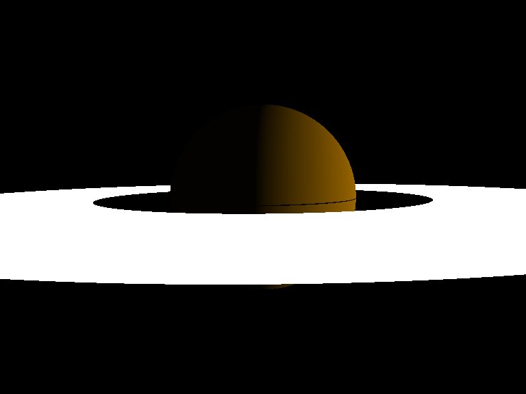

Still trying to get believable Saturnian rings... so I worked through
the media section of the manual to finally get scattering media which
shows cylindrical banding - but my attempts failed so far.
Here is the code for the test scene attached below:
union
   sphere
     0, 1
     texture
       pigment { color rgb <0.6, 0.4, 0> }
       finish { ambient 0.02 diffuse 1 brilliance 0.8 }
   difference
     cylinder
       <0, -0.001, 0>, <0, 0.001, 0>, 3.68
     cylinder
       <0, -0.0011, 0>, <0, 0.0011, 0>, 1.75
     hollow
     pigment { rgbt 1 }
     interior
       media
         emission 0.75
         scattering
           1, 0.1
           extinction 1
         density
           cylindrical
           color_map
             [0 rgbf <1, 0.8, 0.7, 0.1> ]
             [0.3 rgbf <1, 0.8, 0.7, 0.1> ]
             [0.3 rgbf <0.1, 0.3, 0.1, 0.95>]
             [0.35 rgbf <0.1, 0.3, 0.1, 0.95>]
             [0.35 rgbf <0.9, 0.83, 0.3, 0.2>]
           scale 3.68
   rotate <-4, 7, 0>
   scale 10000
   translate z*50000
// end of code
Whatever I tried, the cylindrical pattern never showed up - instead I
got a uniformly white ring! What's my mistake?
See you in Khyberspace!
Yadgar
Download '2009-11-22 media test, take 41.jpg' (11 KB)
Preview of image '2009-11-22 media test, take 41.jpg'

Attached below are two views of Saturn: one showing the sunlit side of
the rings, the other showing the unlit side - but with a conventionally
texture rather than media, I can't get Saturn's shadow becoming visible
on the unlit side. With the real thing, some sunlight instead would be
scattered through to the unlit side, so I started trying scattering media...
Yadgar

From: clipka
Subject: Re: Scattering media with a color_map - how to do?
Date: 22 Nov 2009 23:00:01
Message: <4b0a08c1$1@news.povray.org>
You simply underestimated the effect of scale on media. Scaling does
increase the volume, but leaves the density unaffected, so there's more
matter to emit / absorb / scatter the light.
Reduce the "emission" value (something like 0.005 should get you
started), and you should be fine.
But didn't you want to use scattering media anyway?
Date: 22 Nov 2009 23:13:18
Message: <4b0a0bde@news.povray.org>
> High!
> union
>   sphere
>     0, 1
>     texture
>   difference
>     cylinder
>     cylinder
>     hollow
>     pigment { rgbt 1 }
>     interior
>       media
>         emission 0.75
Considering the final thickness and the view point, that's huge...
>         scattering
>           1, 0.1
>           extinction 1
>         density
>           cylindrical
>           color_map
>           scale 3.68
>   rotate <-4, 7, 0>
>   scale 10000
>   translate z*50000
> // end of code
> Yadgar
Personaly, I'd start by removing the emissive media, or tone it down a
lot. No more than emission 0.001.
Next, use scattering type 5 with a negative exentricity for the outer
rings: most of the incoming light is scattered back. Use a second media
with type 2 or 3 for the inner ring, also, with a much lower density.
Not sure about your use of a filtering component in your color_map.
You scale the rings by 10 000. That means that there is 10 000 times
more media. The thickness of the ring goes from 0.002 to 20. Then, with
your very oblique view, you probably travel at least 5 times longer
through the media. This may explain, toggether with your emissive media,
why you get that saturated white ring.

In other words, and as a general rule of thumb, always divide your
scattering media by the *same amount* (or the same vector) with which you
scaled the object containing the media. You can fine tune around that of
course.
From: Jörg 'Yadgar' Bleimann
Date: 23 Nov 2009 03:26:12
Message: <4b0a4724$1@news.povray.org>
High!
Agustin Britait Molina wrote:
> Some off-topic: The ring's shadow over the planet surface show other shape in
> the real Saturn, you can see this in some real photos of the planet.
> http://www.jpl.nasa.gov/images/saturn/saturn1208-browse.jpg
> Maybe if you scale all the scene 10.000 in size and put the light source very
> very far, the shadow appear more real.
Thank you, but this is only a small test scene, not intended to be
realistic!
Yadgar
Date: 23 Nov 2009 03:36:53
Message: <4b0a49a5$1@news.povray.org>
High!
Meanwhile, I tried this with my original Saturn scene (see my second
posting in this thread)... but then, a new problem occurs: as the
original color and transparency maps consist of 1500 values each, I had
to compose the original color_map from six single color_map put together
in one texture_map (a color_map can only contain up to 255 entries).
As I now reworked the whole thing as a media statement, I got the error
message "Keyword 'texture_map' can only be used in a texture statement."
How can I still build multi-partite color_maps? Or do I have to reduce
the entries to 255?
Yadgar
From: clipka
Date: 23 Nov 2009 08:50:50
Message: <4b0a933a$1@news.povray.org>
> the entries to 255?
"There may be from 2 to 256 entries in the map.
Density maps may be nested to any level of complexity you desire. The
densities in a map may have color maps or density maps or any type of
density you want."
