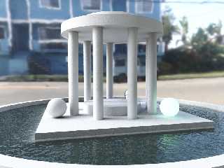

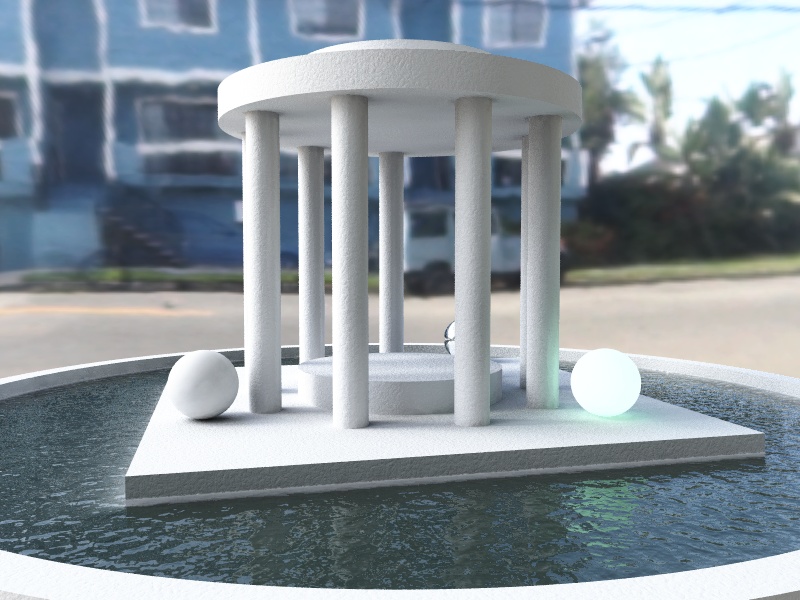

I decided to have a play with HDR. I was getting really really *really* ugly
lighting using radiosity (even with very high quality settings) so this
image was created using Megapov's no_radiosity flag on the sky dome, and 110
area lights sampled from the dome to get the lighting. I did some tests and
110 lights with the right amount of blur looked pretty much identical to
5000 non-area lights.
I chucked a glowing orb in there so you can see it's still doing radiosity,
it's just the light from the HDR image is done using lightsources not
radiosity.
HDR probe is from the website of a friend of mine: http://unparent.com/
(photography->hdr probes)
Comments appreciated, I'm trying to get it to look pretty realistic. I'll
post the source if anyone wants it.
Tek
http://evilsuperbrain.com
Download 'hdr-megapov-1.21.jpg' (156 KB)
Preview of image 'hdr-megapov-1.21.jpg'
From: scam
Subject: Re: hdr
Date: 11 Apr 2007 00:50:01
Message: <web.461c68e6c3e2923b5ffa356d0@news.povray.org>
I like it, although I think you are being let down by the HDR probe you are
using: generally it looks a little wavy, and it is particularly noticeable
on the white trim of the house around the doorway.
Perhaps you could turn that into a feature by adding some mist/steam rising
from the water to imply that is the cause of the wavy effect?
Having said that I like your approach to HDR lighting and I wouldn't mind
having a look at the source.
Cheers.

From: Trevor G Quayle
Subject: Re: hdr
Date: 12 Apr 2007 11:15:01
Message: <web.461e4c64c3e2923bc150d4c10@news.povray.org>
I had a look at the scene and it looks like a good start.  However, It
doesn't use area lights like I thought you had said.  On another note, I
don't think it's necessary to use parallel lights, probably doesn't make
much of a difference though as long as your light dome is big enough.
I must say that I really like the texture on the sphere.  I've been meaning
to try something like that for a metallic paint finish for cars and stuff.
Keep up the good work.
-tgq
From: Tek
Subject: Re: hdr
Date: 12 Apr 2007 11:39:03
Message: <461e5297@news.povray.org>
The scene does use area lights, look:
   light_source {
    dir*1000, col*4/num_lights parallel point_at 0
    #if (area_ang > 0)
     area_light
x*1000*tan(radians(area_ang)),y*1000*tan(radians(area_ang)),4,4 adaptive 1
jitter circular orient
    #end
That metallic paint was just a quick experiment that's turned out much
better than I expected, I'm currently building a car model to show it off
properly :-D
Tek
Subject: Re: hdr
Date: 12 Apr 2007 11:50:01
Message: <web.461e54f4c3e2923bc150d4c10@news.povray.org>
>    light_source {
>     #if (area_ang > 0)
>      area_light
>     #end
You must've uploaded a different file:
light_source { dir*1000, col*4/num_lights parallel point_at 0 }
-tgq
