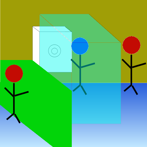

Hunted around on the net and found something for 2D, but I think I got
something wrong trying to do the 3D. Actually, I am semi-sure I know
what I screwed up, but not how to fix it. lol But, I figured I would
maybe, instead, ask here instead, on the chance there is a better solution.
Basically though, I have an object, its position, and its rotation, and
I want to create a "test box" in which to work out where someone is,
but I want it to still work, regardless of whether or not the object is
say, rotated 35 degrees in all directions, placing my "test box" some
place other than at nice 90 angles from the normal axis.
Now the method I had tried was:
main(){
integer left = 0;
integer right = 2;
integer length = 5;
integer top = 1.5;
integer bottom = 1.5;
//Assuming that the "front" is in the Y direction.
  integer boxlen = llGetScale().y / 2;
  vector bbox1 = <pos.x - left, pos.y + boxlen, pos.z - bottom>;
  vector bbox2 = <pos.x + right, pos.y + boxlen, pos.z + top>;
  vector bbox3 = <pos.x - left, pos.y + boxlen + length, pos.z - bottom>;
  vector bbox4 = <pos.x - right, pos.y + boxlen + length, pos.z + top>;
  if (isInsideBox(bbox1, bbox2, bbox3, bbox4))
    //do other stuff, or, else, the stuff you do if they are "not" in
the box.
integer triangleArea(vector A, vector B, vector C)
   //This is where I am screwing up.. I need to test A.z, B.z and C.z,
   //for one of the planes, but I am testing x and y in both cases, which
   //won't work.
   return(C.x*B.y-B.x*C.y)-(C.x*A.y-A.x*C.y)+(B.x*A.y-A.x*B.y);
integer isInsideSquare(vector A, vector B, vector C, vector D, vector P)
   if(triangleArea(A,B,P)>0 || triangleArea(B,C,P)>0 ||
triangleArea(C,D,P)>0 || triangleArea(D,A,P)>0)
       return FALSE;
     else
       return TRUE;
integer isInsideBox(vector bbox1, vector bbox2, vector bbox3, vector bbox4)
   vector P = llDectectedPos(0);
   vector A1 = <bbox1.x,bbox2.y,bbox1.z>;
   vector B1 = <bbox2.x,bbox2.y,bbox1.z>;
   vector C1 = <bbox2.x,bbox1.y,bbox1.z>;
   vector D1 = <bbox1.x,bbox1.y,bbox1.z>;
   vector A2 = <bbox3.x,bbox4.y,bbox3.z>;
   vector B2 = <bbox4.x,bbox4.y,bbox3.z>;
   vector C2 = <bbox4.x,bbox3.y,bbox3.z>;
   vector D2 = <bbox3.x,bbox3.y,bbox3.z>;
   return (isIntegerSquare(A1, B1, C1, D1, P) & isIntegerSquare(A2, B2,
C2, D2));
I am 99% sure that what I failed to think about is that since one of the
"sides" is vertical, I am testing its x and y in both cases, and thus,
stupidly, not testing the z. Otherwise, the code works, supposedly,
because, if your test point isn't "inside the box", one or more of the
area calculations will end up with a negative sign.
In any case, I need to redo the code, if I want to do this, and simplify
things a lot at well.
But, what I was wondering is.. is there some other way to do this? Some
way that takes into account the rotation, and what amounts to a sort of
"is this inside of the bounding box" calculation, without having to
rotation/unrotate various things, to get the same result? Because, as
things stand, either I need to reposition the object I am testing, or I
need to reposition the corner of my invisible box, which I am testing
for them to be in. And, while one is less annoying than the other.. they
are still both annoying. lol

The reason is that I need the specific shape. Ok, I will attach an
example. There is a safe, against a wall, and a counter, which is green,
the transparent box is the "valid" area for someone to be able to access
the safe, with the guy inside it being "allowed", and the two "red"
figures not. There is no way to use a sphere, without detecting as
"valid" people standing in the wrong places. Its the precise reason why
I didn't just use the simpler method of figuring out, "Is this person
standing in the +X direction, and within N meters of the object. That
method would have failed to detect people, in the safe where, instead, a
garage door, for example, if they stood at the "edge" of the door, since
they might not be "close enough", without making the detection range
much larger than I wanted (i.e., a 15 meter door, should detect 5 meters
"in front of" the door, no matter where on the door, but since is using
"center of the door", it would fail to detect someone standing against
it, but 7 meters from the center).

Download 'example.png' (22 KB)
Preview of image 'example.png'

From: Patrick Elliott
Subject: Re: Math question (inside box)
Date: 6 Aug 2013 00:00:02
Message: <520074c2$1@news.povray.org>
On 8/5/2013 4:35 AM, scott wrote:
>>> Thus, only testing "one" box, and only on that single plane.
>>> Then again, I screwed up the last idea so badly... lol
>> And, speaking of which.. again, I forget that the "distance" won't work
>> for objects wider, or taller, than the distance... Sigh...
> Make your bounding box the value of "distance" bigger than the bounding
> box of the object's geometry. That way you are checking for people
> within "distance" from the *edge* of the object, not from the centre.
Only, then it detecting them too far away, when standing directly in
front of it. If I want someone to be able to open a door from 5 meters,
it should be 5 meters, regardless of where they are, when they do it.
Or, in the specific case that led me to hunt for a solution, they can't
be a) on the wrong side of a counter, b) farther than 3 meters from the
safe, c) outside the building (i.e., behind the thing), or d) standing
on the other side of the wall, near the safe (SL lets you pan you camera
through things, with some of its controls, so you can't stop them
clicking the thing, through a wall. This means a very narrow range of
"usable" space, and distance. And the "alley" I need to test, is not
much wider than the safe itself.
I could have gotten by with a fairly simple "angle" test, and distance,
to see if they where close enough, in this specific case. But, not so
with something bigger, like my hypothetical garage door.
Hmm. There is a possibility though..
avPos = llDetectedPos(0);
cPos = llGetPos(0);
ab = llGetAngleBetween(avPos, cPos);
TestDistance = ???(ab) * 5;
I.e., make the angle determine the "distance" so that every point in the
detection range will "always" be the same distance from the object. Ur..
What would be the math for drawing a straight line, using a string,
attached to a immobile peg exactly? lol
