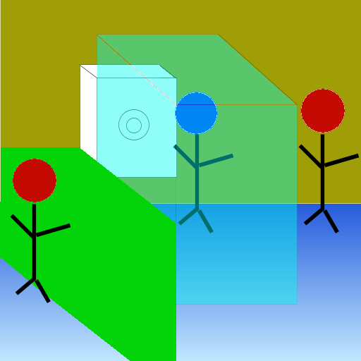

Hunted around on the net and found something for 2D, but I think I got
something wrong trying to do the 3D. Actually, I am semi-sure I know
what I screwed up, but not how to fix it. lol But, I figured I would
maybe, instead, ask here instead, on the chance there is a better solution.
Basically though, I have an object, its position, and its rotation, and
I want to create a "test box" in which to work out where someone is,
but I want it to still work, regardless of whether or not the object is
say, rotated 35 degrees in all directions, placing my "test box" some
place other than at nice 90 angles from the normal axis.
Now the method I had tried was:
main(){
integer left = 0;
integer right = 2;
integer length = 5;
integer top = 1.5;
integer bottom = 1.5;
//Assuming that the "front" is in the Y direction.
  integer boxlen = llGetScale().y / 2;
  vector bbox1 = <pos.x - left, pos.y + boxlen, pos.z - bottom>;
  vector bbox2 = <pos.x + right, pos.y + boxlen, pos.z + top>;
  vector bbox3 = <pos.x - left, pos.y + boxlen + length, pos.z - bottom>;
  vector bbox4 = <pos.x - right, pos.y + boxlen + length, pos.z + top>;
  if (isInsideBox(bbox1, bbox2, bbox3, bbox4))
    //do other stuff, or, else, the stuff you do if they are "not" in
the box.
integer triangleArea(vector A, vector B, vector C)
   //This is where I am screwing up.. I need to test A.z, B.z and C.z,
   //for one of the planes, but I am testing x and y in both cases, which
   //won't work.
   return(C.x*B.y-B.x*C.y)-(C.x*A.y-A.x*C.y)+(B.x*A.y-A.x*B.y);
integer isInsideSquare(vector A, vector B, vector C, vector D, vector P)
   if(triangleArea(A,B,P)>0 || triangleArea(B,C,P)>0 ||
triangleArea(C,D,P)>0 || triangleArea(D,A,P)>0)
       return FALSE;
     else
       return TRUE;
integer isInsideBox(vector bbox1, vector bbox2, vector bbox3, vector bbox4)
   vector P = llDectectedPos(0);
   vector A1 = <bbox1.x,bbox2.y,bbox1.z>;
   vector B1 = <bbox2.x,bbox2.y,bbox1.z>;
   vector C1 = <bbox2.x,bbox1.y,bbox1.z>;
   vector D1 = <bbox1.x,bbox1.y,bbox1.z>;
   vector A2 = <bbox3.x,bbox4.y,bbox3.z>;
   vector B2 = <bbox4.x,bbox4.y,bbox3.z>;
   vector C2 = <bbox4.x,bbox3.y,bbox3.z>;
   vector D2 = <bbox3.x,bbox3.y,bbox3.z>;
   return (isIntegerSquare(A1, B1, C1, D1, P) & isIntegerSquare(A2, B2,
C2, D2));
I am 99% sure that what I failed to think about is that since one of the
"sides" is vertical, I am testing its x and y in both cases, and thus,
stupidly, not testing the z. Otherwise, the code works, supposedly,
because, if your test point isn't "inside the box", one or more of the
area calculations will end up with a negative sign.
In any case, I need to redo the code, if I want to do this, and simplify
things a lot at well.
But, what I was wondering is.. is there some other way to do this? Some
way that takes into account the rotation, and what amounts to a sort of
"is this inside of the bounding box" calculation, without having to
rotation/unrotate various things, to get the same result? Because, as
things stand, either I need to reposition the object I am testing, or I
need to reposition the corner of my invisible box, which I am testing
for them to be in. And, while one is less annoying than the other.. they
are still both annoying. lol

Why would you want to handle such box, when the interest of such code is
precisely to reduce the workload by looking only at the axes.
> main(){
> integer left = 0;
> integer right = 2;
> integer length = 5;
> integer top = 1.5;
>    //do other stuff, or, else, the stuff you do if they are "not" in the
> box.
>   //won't work.
>       return FALSE;
>     else
>       return TRUE;
Did you understand how it is supposed to work in 2D ? I mean the
previous two functions are using oriented triangles and area computation
(signed result) to know if P is inside ABCD.
When P is inside ABCD, ABP, BCP, CDP, DAP all have the same sign for
their area. As soon as P is outside the square, one area at least has a
negative result.
The nice thing about it is that the four points A,B,C & D only need to
be ordered in the rotating order and can be anywhere in the plane (it
does not have to be an axis-aligned square).
But it only works in 2D.
> C2, D2));
I do not understand the expectation here. You seems to transform the box
as two parallel to Z plane squares (axis-aligned), and then check if the
projection of P is inside the projections of both these squares.
There is plenty of situations where it will provide false positives, as
well as false negatives.
signed area calculation is only good for 2D. The extension in 3D would
need to compute the volume of a pyramid (with a triangle base) and the
maths are not to be friendly
If you do not intend to limit yourself to a axis-aligned box, why not
instead use a sphere ?
you transform only 1 point (the center)(if you only have rotation and
translation), and then just compute the distance of the center to P (to
compare against the radius). And to avoid slow squared root, compare the
squared distance (euclidian) to the squared radius.
If you have more than rotation & translation (such as scaling and
shearing), you might need to transform the radius too (at which point,
it's better to consider 1 center and the 8 corners of the box, to
finally only kept as radius the distance from the center to the most
faraway corner)
(the box is originally the box that encloses the minimal sphere. at the
end, the radius is the radius of the sphere that encloses the
transformed box. Thus, it is bigger than the strict covering sphere, but
it is safe)

The reason is that I need the specific shape. Ok, I will attach an
example. There is a safe, against a wall, and a counter, which is green,
the transparent box is the "valid" area for someone to be able to access
the safe, with the guy inside it being "allowed", and the two "red"
figures not. There is no way to use a sphere, without detecting as
"valid" people standing in the wrong places. Its the precise reason why
I didn't just use the simpler method of figuring out, "Is this person
standing in the +X direction, and within N meters of the object. That
method would have failed to detect people, in the safe where, instead, a
garage door, for example, if they stood at the "edge" of the door, since
they might not be "close enough", without making the detection range
much larger than I wanted (i.e., a 15 meter door, should detect 5 meters
"in front of" the door, no matter where on the door, but since is using
"center of the door", it would fail to detect someone standing against
it, but 7 meters from the center).

Make your bounding box the value of "distance" bigger than the bounding
box of the object's geometry. That way you are checking for people
within "distance" from the *edge* of the object, not from the centre.

That's a good idea.
> lol What part of, "I know I screwed up the math.", did people miss. ;)
> Seriously though, Le_Fogeron says it wouldn't work anyway... :p
The test against 6 planes would work, and is easy if it is axis aligned.
If it is rotated, you have "just" to apply the same maths, it's just the
formula which become a bit harder (a plane equation is ax+by+cz+d = 0,
one side of the plane is wherer ax+by+cz+d > 0, and the other side is <0)
There is an infinity of 4D vector <a,b,c,d> to match a single plane
(indeed, if V is such vector, k.V is also another vector)
(also notice that if V is such vector, -V is the same plane but with the
inversion of the sides)
So, instead of thinking "corner of box" (8) to be grouped in
squares/side, you should have to think "plane's equation" (6).
Notice that scaling & shearing leaves plane as plane, so even if you
were to use a sheared box (such as a truncated pyramid), it would still
works.
What I said was that extending the "smart" 2D triangle-based-tests to 3D
are to be a nightmare.
Just because nobody complains does not mean all parachutes are perfect.

Only, then it detecting them too far away, when standing directly in
front of it. If I want someone to be able to open a door from 5 meters,
it should be 5 meters, regardless of where they are, when they do it.
Or, in the specific case that led me to hunt for a solution, they can't
be a) on the wrong side of a counter, b) farther than 3 meters from the
safe, c) outside the building (i.e., behind the thing), or d) standing
on the other side of the wall, near the safe (SL lets you pan you camera
through things, with some of its controls, so you can't stop them
clicking the thing, through a wall. This means a very narrow range of
"usable" space, and distance. And the "alley" I need to test, is not
much wider than the safe itself.
