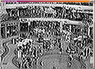

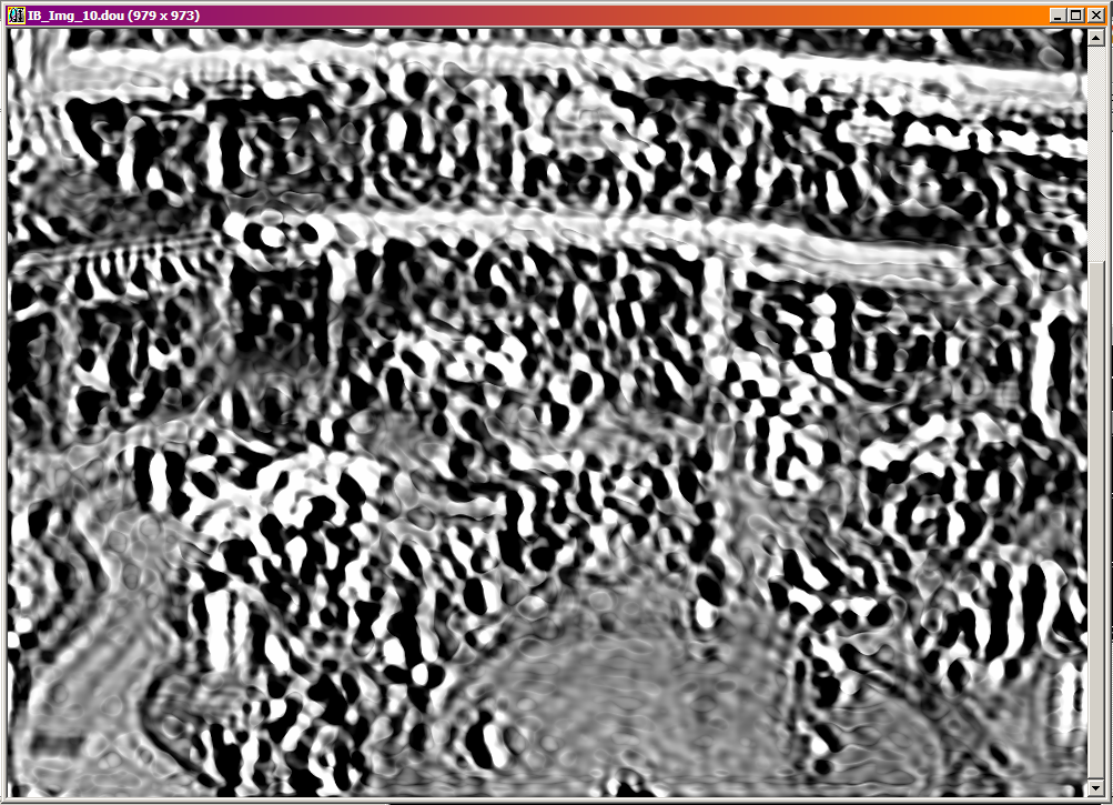

On 02/12/2011 10:30 AM, Invisible wrote:
> [Img_Support_ht_wd]. If you set the value of this field equal to the
> input image dimensions, then the program appears to lock up for an
> insanely long time. Eventually it outputs a non-blank image. It is
> *vastly* more blurry than the input. I mean, you can barely tell what
> the hell it *is*.
> Then I noticed that I set the program for 5 iterations. The example in
> the documentation shows 2000 iterations. So I tried higher...
This is what the image looks like after 10 iterations. It took 15
minutes to perform the computation.
As you can see, the image is garbage. If you look back at the original,
you can JUST BARELY make out some of the really obvious features, like
the balconies and vertical blobs that might be people. But that's about it.
Download 'iter010.png' (603 KB)
Preview of image 'iter010.png'

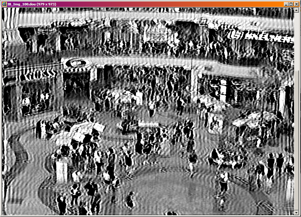

From: Invisible
Subject: Re: Deblurring [100 iterations]
Date: 2 Dec 2011 05:35:38
Message: <4ed8a9fa@news.povray.org>
Here it is again after 100 iterations. (I don't have a record of how
long that took.)
The squiggles are higher-frequency now, and if you already know what the
image is supposed to look like, you can just about tell what the various
blobs are. Obviously this is in no way an "improvement" on the blurry
original.

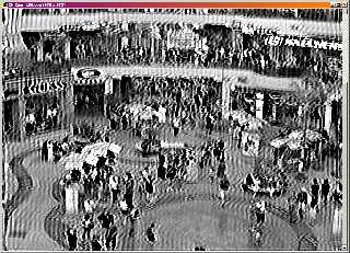

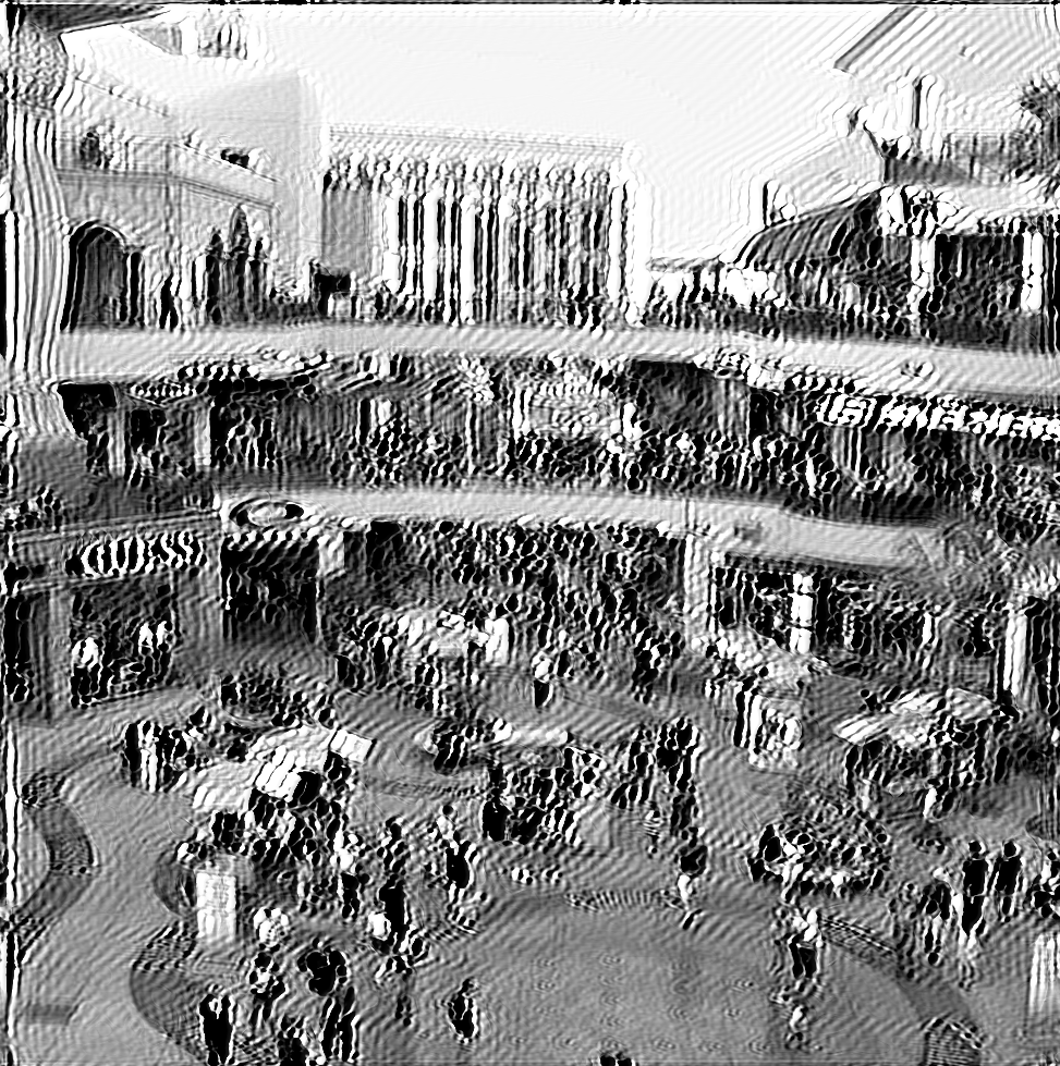

From: Invisible
Subject: Re: Deblurring [500 iterations]
Date: 2 Dec 2011 05:41:26
Message: <4ed8ab56@news.povray.org>
Here we are again, after 500 iterations. That's almost exactly 12 hours
of computer time, on [one core of] an Intel Core2 Duo 2.2 GHz running in
32-bit mode.
12 hours, to generate... this??
In fairness, the motion blur seems to be gone. It's just that the crazy
zigzag lines are far worse than what we started with. Note also how
every image /is/ an improvement on the one before. So it looks like if I
leave this running for, say, a month... I might actually get back a
usable deblurred image.

combination of settings I've found which doesn't produce a black image.
Caveat #2: The Photoshop thing is probably using the GPU to accelerate
the **** out of this stuff. It wouldn't surprise me if taking 2D DFTs is
vastly faster on a GPU than on a CPU.
Download 'iter500.png' (794 KB)
