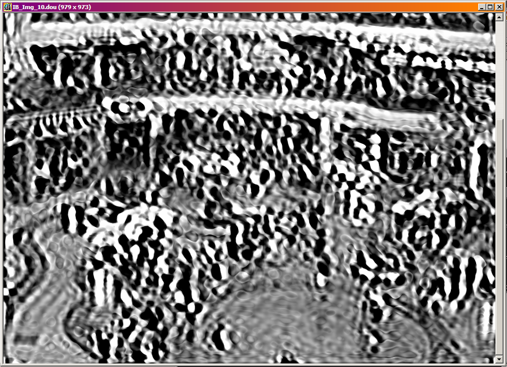

This is what the image looks like after 10 iterations. It took 15
minutes to perform the computation.
As you can see, the image is garbage. If you look back at the original,
you can JUST BARELY make out some of the really obvious features, like
the balconies and vertical blobs that might be people. But that's about it.

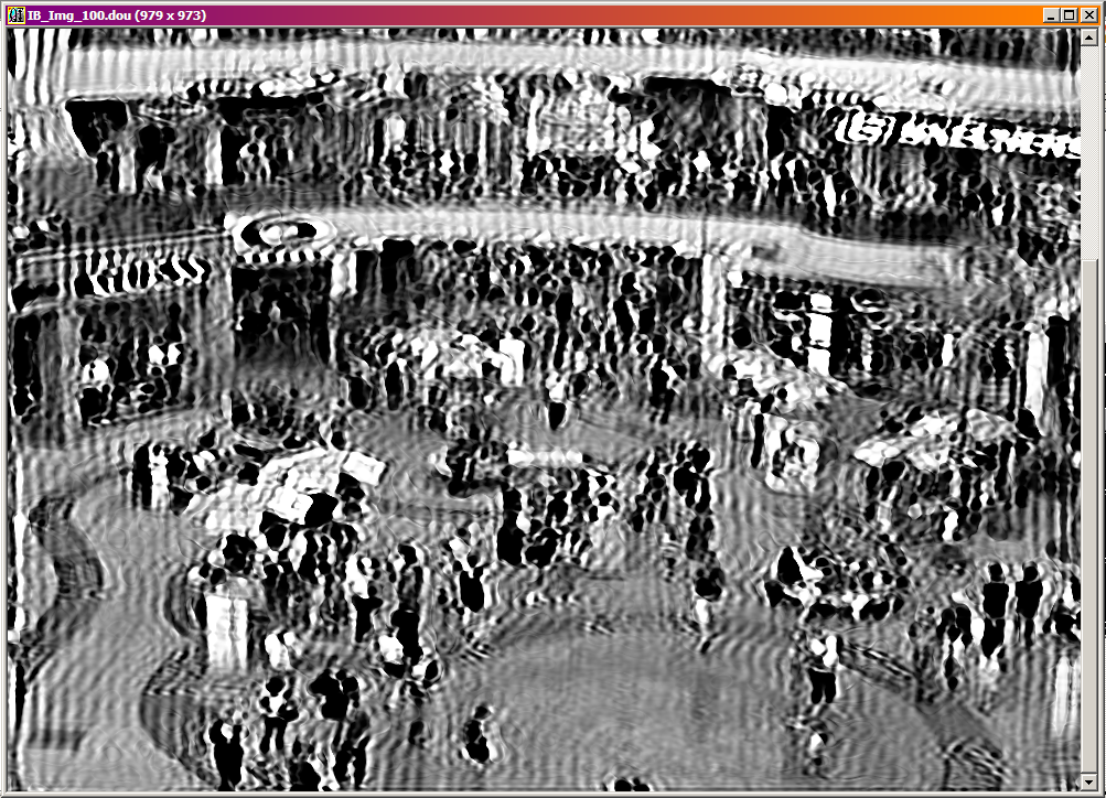

Here it is again after 100 iterations. (I don't have a record of how
long that took.)
The squiggles are higher-frequency now, and if you already know what the
image is supposed to look like, you can just about tell what the various
blobs are. Obviously this is in no way an "improvement" on the blurry
original.

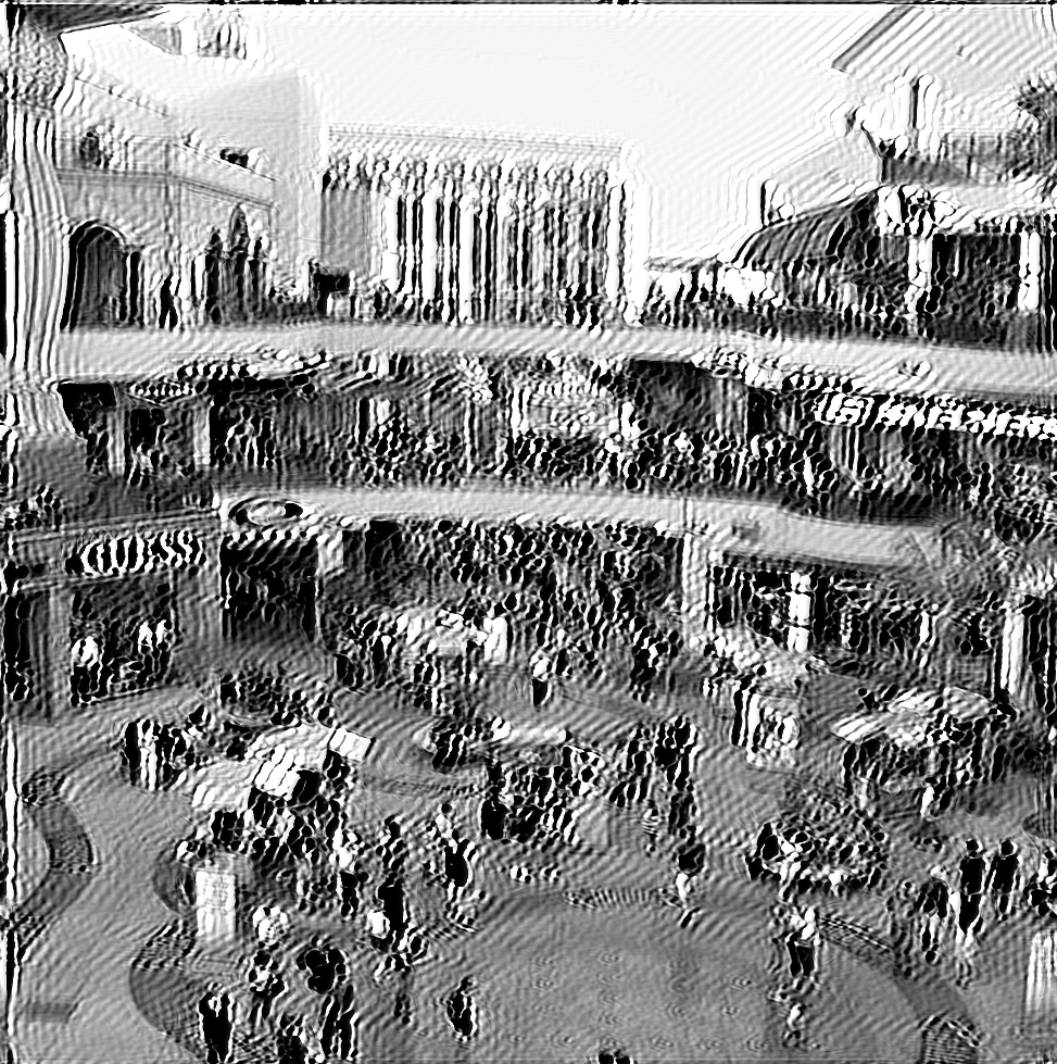

Here we are again, after 500 iterations. That's almost exactly 12 hours
of computer time, on [one core of] an Intel Core2 Duo 2.2 GHz running in
32-bit mode.
12 hours, to generate... this??
In fairness, the motion blur seems to be gone. It's just that the crazy
zigzag lines are far worse than what we started with. Note also how
every image /is/ an improvement on the one before. So it looks like if I
leave this running for, say, a month... I might actually get back a
usable deblurred image.

Download 'iter500.png' (794 KB)
Preview of image 'iter500.png'

On 12/2/2011 2:41 AM, Invisible wrote:
> Caveat #2: The Photoshop thing is probably using the GPU to accelerate
> the **** out of this stuff. It wouldn't surprise me if taking 2D DFTs is
> vastly faster on a GPU than on a CPU.
I believe that the initial implementation of their algorithm ran on a
single CPU core and took six minutes for a 1-megapixel image.  The
current version is probably better though.
