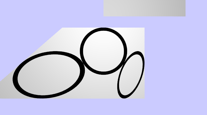

On 3/25/2023 2:21 AM, Thomas de Groot wrote:
> Op 24-3-2023 om 22:36 schreef Josh English:
>> Yup. uv_mapping needs to be triggered on the texture and the object to
>> work. I played with it a bit more and managed to get the torus onto
>> each triangle that has the Test texture
> I have bit of a problem with this:
>> #declare TorusRadius = sqrt(3)/6;
>> #declare Torus = torus {TorusRadius-Line, Line rotate x*90 translate
>> <0.5, TorusRadius-Line, 0>}
> and I got a better fit with:
> #declare Line = 0.02;
> #declare Torus = torus {sqrt(3)/8, Line rotate x*90 translate <0.5,
> sqrt(3)/6, 0>}
> ...which is less elegant but which fits better the triangle centres
> somehow. I don't know how to translate this to your solution though.
It looks good to me. I didn't get a satisfactory "kiss the edge of the
triangle" look but I didn't do a lot of heavy math. Even the sqrt(3)/6
was a guess that just seemed to work well enough.
I made a few more adjustments to the code
<0.5, TorusRadius, 0>}
And then I experimented with stretching some triangles, which would
happen in a mesh and got the expected distortions of the radius. I'm not
sure that's even possible to fix without customizing ellipses for each
triangle, so probably at that point a cylinder and not a torus creates a
better marker.
Download 'uv_test.png' (27 KB)
Preview of image 'uv_test.png'

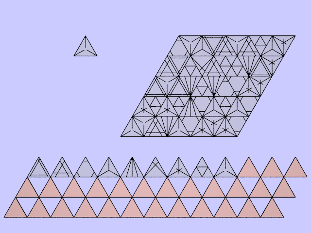

From: Bald Eagle
Subject: Re: uv mapping triangles in mesh {}
Date: 25 Mar 2023 18:35:00
Message: <web.641f76beeebe912c1f9dae3025979125@news.povray.org>
> > And you definitely are catching on to where I'm going with that.  ;)
> Eagerly awaiting further developments...
So, after I figured out that the basic mechanism of the uv_mapping was going to
work out the way that I wanted, I figured I'd give some Japanese kumiko a try.
I converted some of:
https://github.com/BorisTheBrave/grids/blob/main/src/updown_tri.py
But perhaps have to figure out how to mimic a python yield directive in SDL -
maybe TOK has some ideas on that.
Then I worked out a bunch of ternary diagram macros and made sure that was
working out ok.
Then I started making some of the patterns, hit a few snags, then tried to get
partial lines running from a vertex across the triangle, and --- that's when I
lost my mind.  I'll take tensor calculus any day over the simple stuff  :D
I found this:
https://medium.com/@deltaplotware/ternary-diagrams-in-chemistry-6c608ae5137b
showing the constant composition lines, but I haven't worked it out yet.
Anyway, here's the development doodles to give you an idea of where this is
going, once it gets organized.   I think the end goal is to be able to scan an
image and use the color data to put the appropriate kind of pattern in the
triangular pixel.  Kind of like an ASCII art, eval_pigment, halftone thing - but
made of 100,000 little pieces of wood.
Enjoy.
- BW
Download 'ternaryplot.png' (92 KB)
Preview of image 'ternaryplot.png'

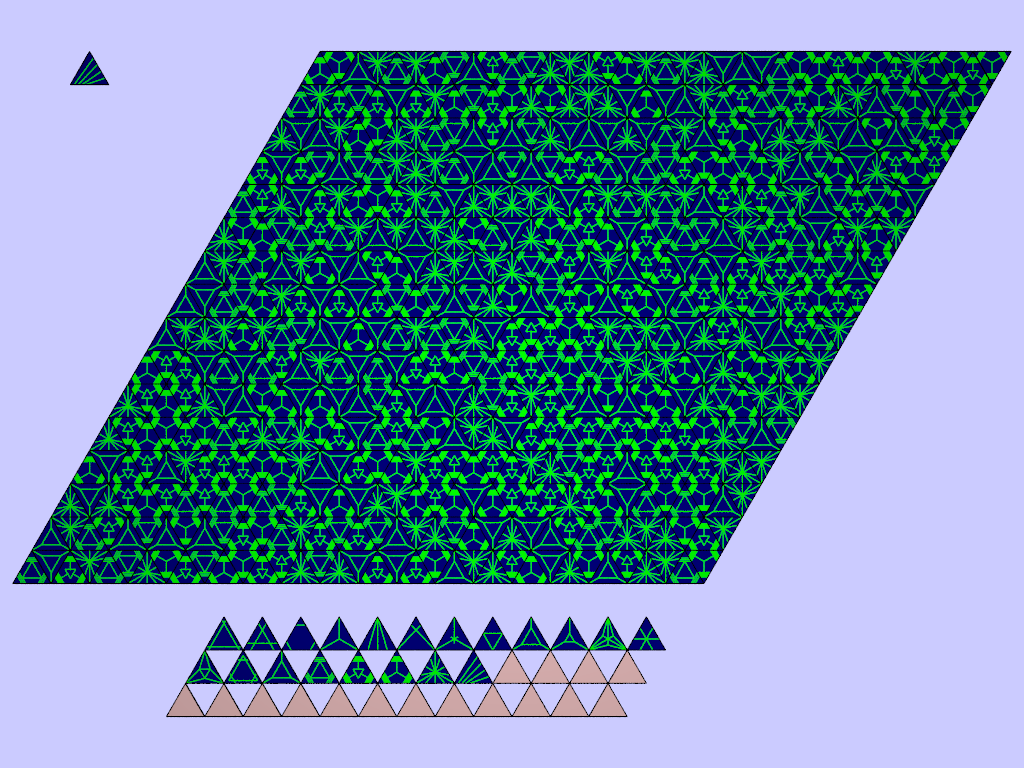

From: Bald Eagle
Date: 26 Mar 2023 14:40:00
Message: <web.64209154eebe912c1f9dae3025979125@news.povray.org>
> Phew... I need to ponder this a bit more but this leads to very
> interesting potential possibilities. I have experience with eval_pigment
> to do this kind of thing, but this is just a bit smarter. Well done so far.
Well, what we're doing is instead of just using the underlying pigment value
returned by eval_pigment directly, we're using that color or grayscale value to
choose a shape that represents that "brightness".
You can do it with text (ASCII art), I've done it with the halftone project
using holes of different sizes (I _cannot_ find the thread), and here I'm going
to try it with the patterns filling the triangles.
I got some sleep, got my head screwed on straight, figured out the
constant-ratio lines, and that got me a bit further along on pattern
development.
Now I'm again a little stuck on lines perpendicular to edges, and that also
hinted that maybe somewhere in the code I have a few things switched around.   I
have to check once get all the code written, and it could just be a matter of
swapping #cases of a #switch block.
Anyhow,  I have most of what I wanted to do completed.  I also noticed the
overall impression of the assembled patterns is very different depending on
color choice.  I'll likely have to finish working through the triangle grid code
to get that all properly converted so that I can rotate triangles, select the
triangles that fill a rectangle, etc.
All in all, not bad for a weekend of coding.
Download 'ternaryplot.png' (483 KB)

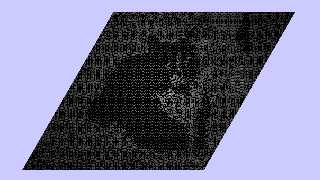

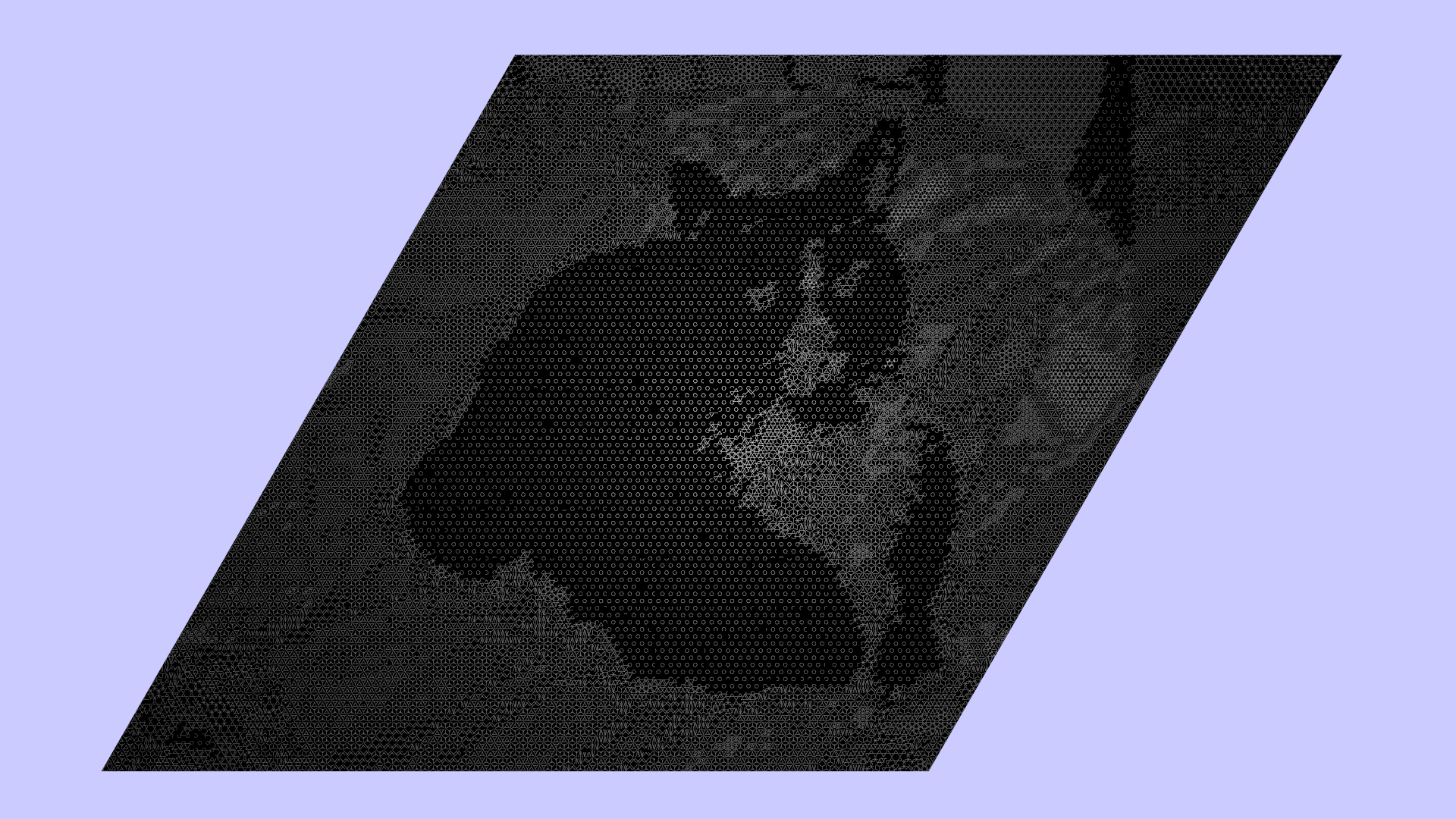

From: Bald Eagle
Date: 26 Mar 2023 19:40:00
Message: <web.6420d7b5eebe912c1f9dae3025979125@news.povray.org>
And here you go, Internet.   A cat.
Download 'kumikophoto.png' (1604 KB)
Preview of image 'kumikophoto.png'
