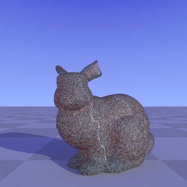

I went looking for sslt scene code, and that rotating pyramid again...
and got sidetracked.
Here's some granite with HDR lighting and radiosity.
I noticed that I probably didn't scale the texture properly, and so I can't
really see any of the veins.  In my readings, clipka mentioned that having the
mm_per_unit setting was there to decouple the texture from POV-units and so be
independent of scaling effects.  We might want to do similar with a
default-if-not-supplied, and a debug/warning message saying what it got set to.
I think that sometimes it is a bit slow to render - depending on how the scene
is set up.   Maybe have some quick-color definitions set up.  For ridiculously
high quality, I'm guessing we'd want some switchable reflection built in as well
for the same not0 reasons.
Download 'dakotaredradiosity.png' (3990 KB)

Subject: Re: Dakota Red Granite macro - beta #1.2
Date: 24 May 2021 07:31:27
Message: <60ab8e8f$1@news.povray.org>
Op 24-5-2021 om 12:22 schreef Bald Eagle:
>> In the meantime, I am also working on a working sslt set... Not so easy!
>> For instance, a layered texture (veins!) makes sslt go bad.
Looking good and interesting.
Something I noticed with sslt in my settings, is that veins seem to
become really 'thin' or, more probably, 'transparent', and thus tend to
/disappear/ from the view except with higher magnification.
There are still a lot of issues with the technique (the layered textures
I mentioned for instance) which are not (fully) addressed in the
documentation as-is. Not for nothing that the technique is still
experimental. However, we may get at something workable if not
breath-taking ;-) on the way.

/lower/ layer and *not* in the top layer. Just comment it out there.
(2) Scaling of the granite material is related to the /original/ size of
the object. In my system, I scale the bunny 10x /before/ applying the
granite material. Consequently, I use the optional M_scale = 0.10; or
close to that value in the macro.
Date: 24 May 2021 11:33:52
Message: <60abc760@news.povray.org>
Op 24-5-2021 om 15:01 schreef Thomas de Groot:
> For your consideration, concerning sslt:
> (1) It looks like that when using the layered texture mode, i.e. with
> veins through the granite, sslt should *only* be switched on in the
See attached image. Translucency has been a bit exagerated:
  <0.669, 0.229, 0.198>*5;
In fact this has nothing to do with sslt;-)
Download 'dakotared_sslt_test1.jpg' (59 KB)
