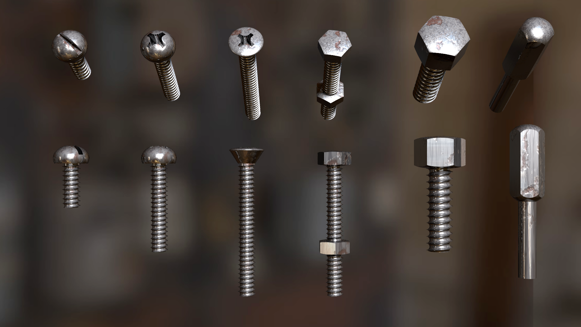

Rendering of screws. Just posted the scene and macro's for generating a few
screw/bolt types. Working in a distressed steel material. Like flies, theses
will start showing up in my renderings. :)
Mike.
> Mike.
You forgot the Robertson head.
It's square, slightly wider at the top by about 2% to 3%.
> Mike.
I'm sure the threads must be a real challenge to get right.
We had a guy work out a bunch of the math for getting the right thread profile,
a while back.
I'm sure there are other macros for generating screw threads - It's something
I'm certain could be expanded into a field of its own.  Just paging through
Machinery's Handbook, it's an extensive topic.
https://news.povray.org/povray.general/thread/%3C875zph8073.fsf%40munyer.com%3E/?ttop=437822&toff=200
- BW

From: Mike Miller
Subject: Re: screws.png
Date: 24 Apr 2023 17:45:00
Message: <web.6446f7d7a70a9db459197626dabc9342@news.povray.org>
> > Mike.
> a while back.
> - BW
I kinda cheated with the treads. I use a macro for a cubic spine coil that's
driven by bolt length and radius - I use it to boolean cut the bolt. There's
probably a better way. Thanks for the info.
Mike.

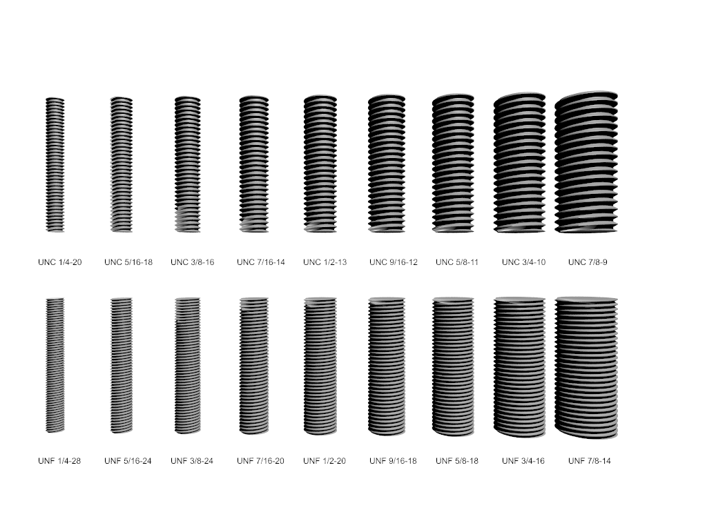

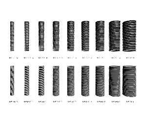

I created isosurface functions for machine screw threads that take the
major diameter and thread count as parameters.  The functions are more
turnkey than Robert Munyer's code, and give the same results.
https://news.povray.org/5eec257c%241%40news.povray.org
Beware, there is an illegitimate apostrophe in my post.  I didn't notice
it until too late.
From: Bald Eagle
Date: 24 Apr 2023 21:30:00
Message: <web.64472d10a70a9db41f9dae3025979125@news.povray.org>
That first function works very nicely.  The rest will have to wait until later.
With jr's tabulated macro, these would make very nice standard thread charts.
POV-Machinery, Inc.
> it until too late.
Neither did the question mark and the exclamation point...   :D
Well done, as usual.
- BW
