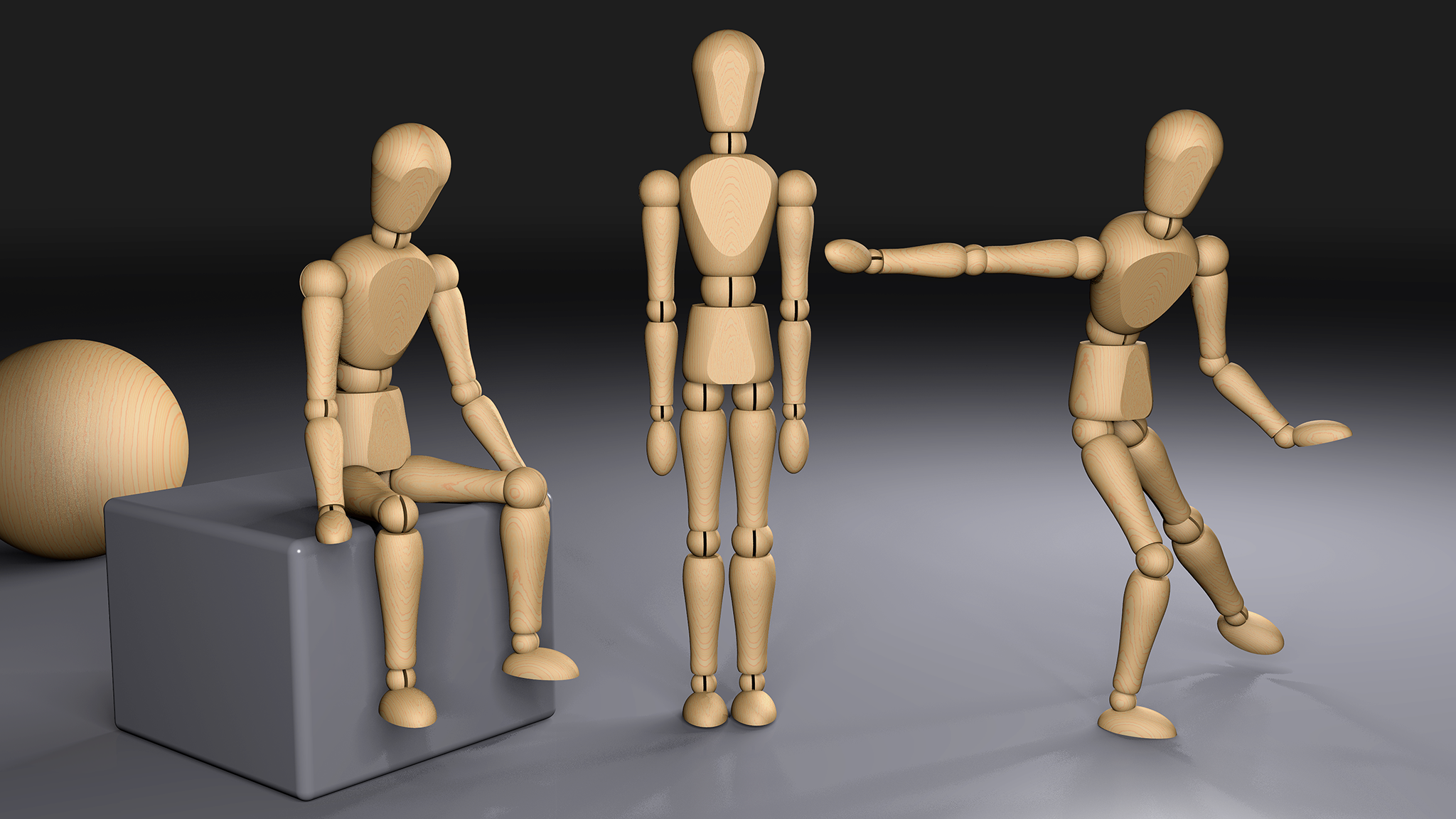

Rendering of a poseable wood mannequin. Modeled for my Jack/workbench scene. I
posted the scene file. Most pivots are programmed with 2 rotations. The upper
arm could use an additional y rotation. The include file could use some
additional commenting and poses. Might try to work out a run sequence.
Miller
Download 'wood_mannequin.png' (1601 KB)
Preview of image 'wood_mannequin.png'

You are stirring old memories... I built one some twenty or more years
ago, using Moray, in order to learn about inverse kinematics. No idea
where the little critter is hiding now... :-)

I would love to see it. Inverse kinematics would be the way to go. I've used it
in Max - it has an 'end effector' that pushes the links, but required rotation
restriction on all the joins. Beyond my programming skills. Share if you find.
I'm using a simple forward method with parent/child unions. I modeled this
yesterday day and started to write the rotates to pose this into my scene ...it
got more complicated today when I decided to control all the joins. haha.
Mike

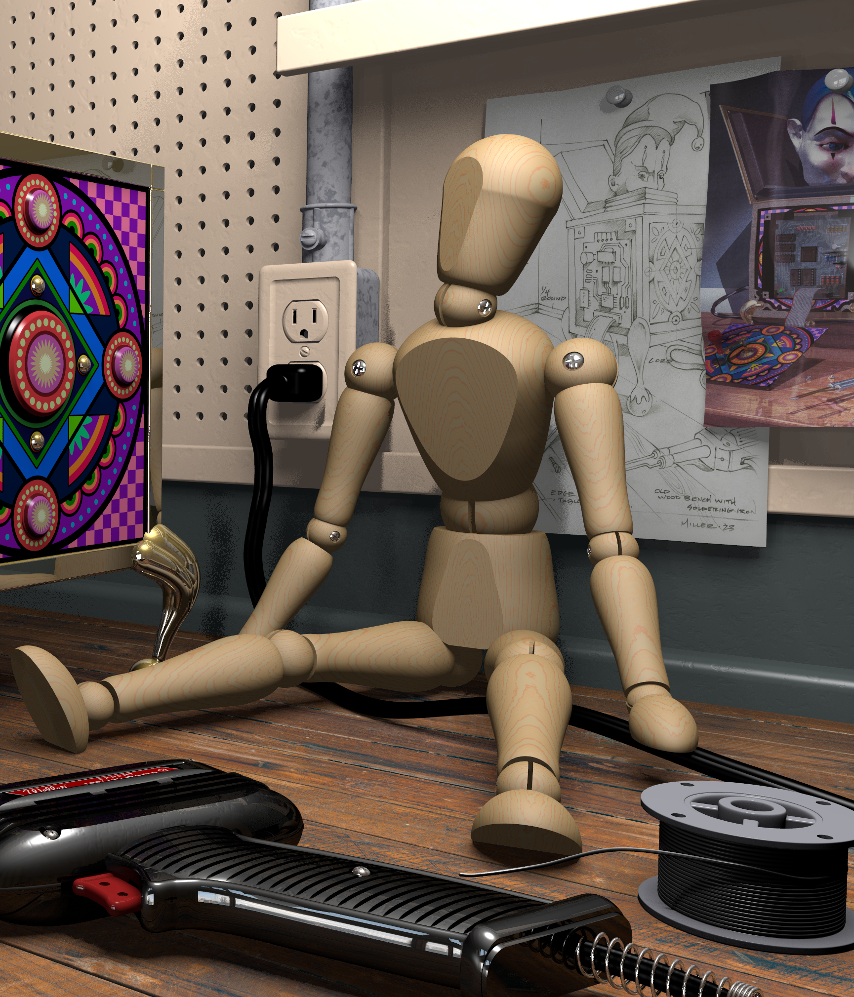

Nice, thanks. I have to take a peek at his code. It looks very close to the same
wood mannequin I have beside me. Don't have the female version. I just added the
screws at the ball joints. My physical mannequin has brass screws.
Mike.
Download 'workbench8.png' (4515 KB)
Preview of image 'workbench8.png'
> > Mike
> Hi Mike (and everyone),
> Fabien Mosen created a mannequin image for the IRTC back in 1998:
> https://www.irtc.org/ftp/pub/stills/1998-12-31/fmenc.jpg
> https://www.irtc.org/ftp/pub/stills/1998-12-31/fmenc.txt
> https://www.irtc.org/ftp/pub/stills/1998-12-31/fmenc.zip
> Colin.
Thanks Colin. I've pulled in the files. Cool that most the mannequin forms are
modeled with a sphere/cylinder blob pairing.
Mike.
