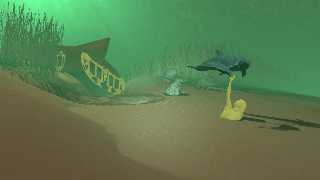

I'm totally frustrated at the moment having lost the Tina-Chep deadline. But
after having rendered a most of the scene I got a blue screen and all was lost.
I tried to start it over, but the deadline was lost. So you can look at the
picture here. And please nitpick about it. The title is "Lost Beauty". The topic
was "After the storm".
Best regards,
Michael
Download 'lostbeauty.png' (2002 KB)
Preview of image 'lostbeauty.png'

I like the concept very much. Lots of good elements in the scene.
I detect some focal blur; but there aren't enough objects in the foreground to
really sell that. Perhaps some fuzzy darker shapes in the lower left would help
(and would also help balance the composition, IMO.)
The 'overall' color cast of all the seas-floor elements should, I think, be a
little more to the blue-green. A more restricted color palette, in other words.
That is, unless the idea is that there are lights down there, artificially
lighting up the environment.
Final nitpic: The statue, where it meets the sand, seems to need
something--grunge, or a pit/raised sand area. I'm not sure what actually happens
to buried objects in a sandy sea bed; it just looks a bit too abrupt and clean.

I am sorry to hear that Michael, and already with so few images in this
round. Thanks for putting the image here so that we can at least enjoy it.
This is a difficult type of scene to do indeed. I like the way you have
treated the water as a media, although I would have liked to see small
debris in suspension. I recall a shark by Jim Charter which showed that
and it was very effective to recreate a watery environment. Shouldn't
sun rays be more visible, broken by surface waves/ripples, with light
spots on the sand?
I agree with Kenneth about the sand around the statue (the figurehead of
the ship, I suppose?). Not sure how it would have to look but I think
that small water currents would create ridges and furrows around it.
I love the way the dolphin nibbles the hand :-)
Overall, well done; maybe the scene is a bit too empty, but that is just
my 2 cents.

It was very late as I posted this picture and I was a bit too tired to give
remarks about the picture. I experimented a while with an isosurface sea and
yielded some nice effects, but not the one I wanted. So I fall back to tweak the
sea by Johnny Yip until I came close to my imagination. So credits for the sea
goes to Johnny mostly.
You are right about that both.
Thanks.

too bad ... you probably could have tweaked it for "woman" topic too.
But nice image and good underwater feel in the distance.
