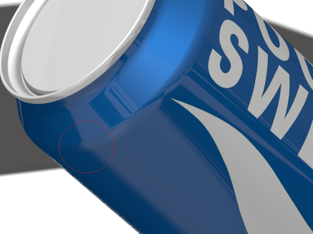

Hi,
I was modelling a pop can using a couple bezier spline lathes and there is a
reflection that does not look right to me.  I am confident the segment
boundaries are straight but the reflection does not seem to match the curve.
Am I just seeing things?  If not, where is a good place for me to start looking
in the source (or is this a known issue?)
Thanks,
Mike
Download 'bezier lathe problem.png' (490 KB)
Preview of image 'bezier lathe problem.png'

Am 18.08.2011 07:21, schrieb Solar Mike:
At boundaries between flat and highly curved surfaces, reflections can
play some pretty surprising tricks with our eyes, so it may well be
accurate after all.
Try to put some long narrow cylinder(s) at that particular place on the
ground to see things more clearly; I somehow suspect that what you think
is a single contiguous line may actually be two orthogonal lines.
   If using 'sturm' does not solve the problem, you could try the
MeshLathe include at lib.povray.org to see if it helps (if for nothing,
then to corroborate that it should look as you expect).

I did try adding 'sturm' and created a matching mesh and got the same results.
I'm still have not wrapped my head around why the reflections are like that but
I'm satisfied that the render is done correctly and I've simply fallen for a
"surprising trick" the reflection is making.
Thanks :)

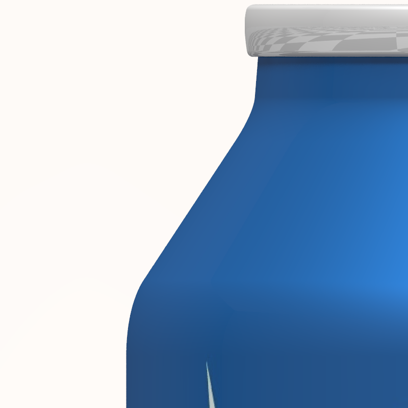

Have you tried clipping the lathe (or intersecting it) with plane { -z, 0 } to
see if it looks straight from that point of view?

I have done that and it seems fine to me.  I've attached an orthographic view
straight on from the side.  It's not perfect by any stretch but it is pretty
close.
Download 'popcan ortho detail.png' (83 KB)
Preview of image 'popcan ortho detail.png'

I noticed that at the top your can has a dark band at the bend (and a less
visible lighter one in the middle) although logically I would say there is no
reason for that color shift. Maybe that has the same background as your
reflection problem?
