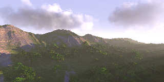

So I'm continuing on my acquaintance with media.  I have this scene where I have
a large sphere with sparse media which acts as atmosphere.  Then, I add an oval
which contains much denser media in order to make a cloud (which is within the
large sphere, of course).  I'm happy with the results of either media when used
independently, but in this picture you can clearly see the outline of the oval,
as if the oval cancels the other media with its own.  Can someone help me with
this?
My current solution is to define everything as a function, and then simply add
the functions together and just have one object with a complicated media
definition.  This works, but with the downside that I have to used more samples
on *everything* rather than just on the clouds which need the greater
definition.  This slows the render considerably.
(The samples are not turned up very high in this render, by the way)
Download 'hftester02.png' (204 KB)
Preview of image 'hftester02.png'

I suspect that it is indeed the problem that interiors are not
generally additive (e.g, what would it mean to have two diffent
iors) and further confusing because except for media most interior
stuff is only calculated for the surface, not volumetric. I didn't
find anything explicit in the documentation, though.
> definition.
Have you tried using the complicated function only in the oval?
If the density of that function matches the density of the simple
atmosphere function at the oval boundary, it might help to get
rid of that effect without requiring the complicated function
for the entire atmosphere. But I suppose the boundary might
still appear due to sampling artefacts.

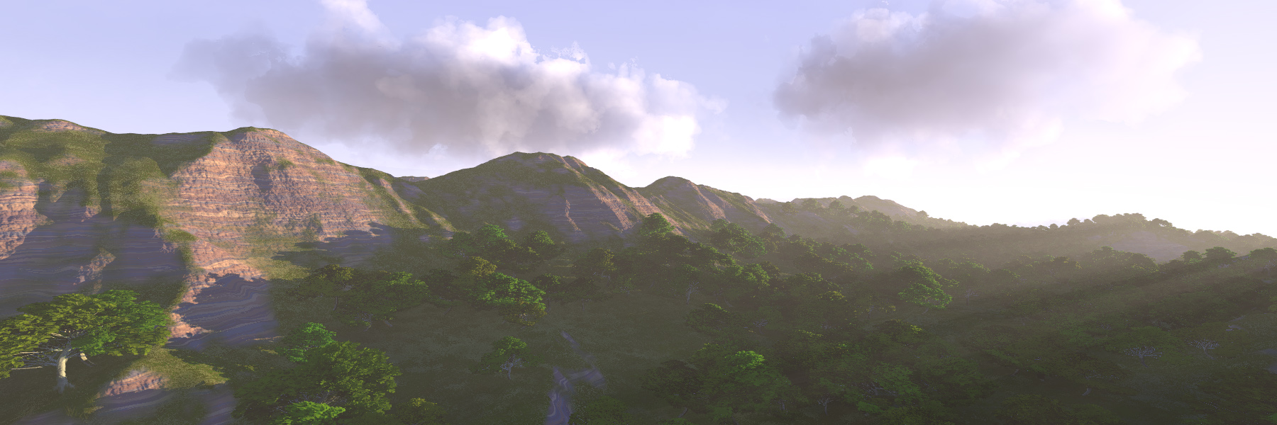

Well, I'm finding that despite the longer render times, using more samples
overall has some distinct advantages, such as the light streaks you get in this
render.  In reality, the media did not have nearly as much effect on the render
time as did the forest, once you add radiosity and AA.  I'm pretty happy with
the results here, although I'd like to change the shape of the clouds a bit and
perhaps add more.  The forest could use some more variety in the vegetation, as
well.

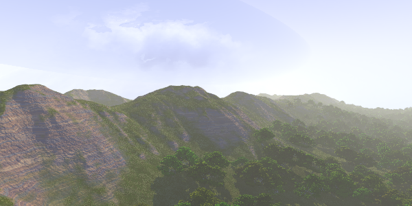

Well, here's some more tests.  This one was done with samples at 20 and took
about 36 min.  As you can see, there's no AA on this one, though.  Even at 20,
you can still see that "shelving".
I suppose one could cut up your atmosphere into segments, and have something
like:
intersection {
  sphere {0, AtmosphereSize}
  box {<-Size,0,-Size>, <Size, CloudAlt, Size>}
  ...samples 1,1...
  density {MediaFunction(x,y,z)}  //all using the same function
intersection {
  box {<-Size,CloudAlt,-Size>, <Size, CloudAlt+CloudDepth, Size>}
  ...samples 20,20...
But I suspect that in some way the tangent surfaces would show up.  Also, I'm
finding that changing the samples tends to affect the apparent density.  So the
density of the background might be obviously different in the two boxes.
