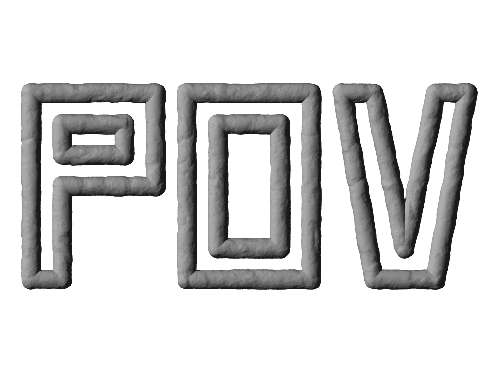

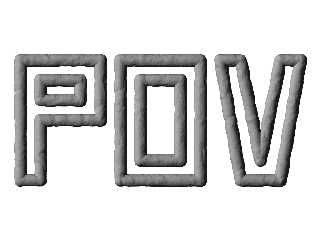

another example of sphere sweep as on iso
ABX
#declare _=function(a,b,x){((a^2)+(b^2))^.5-x}#default {pigment{color rgb 1}}
union{plane{y,-3}plane{-x,-3}finish{reflection 1 ambient 0}}isosurface{ //ABX
function{_(x-2,y,1)&_((x+y)*.7,z,.1)&_((x+y+2)*.7,z,.1)&_(x/2+y*.8+1.5,z,.1)}
contained_by{box{<0,-3,-.1>,<3,0,.1>}}translate z*15finish{ambient 1}}//POV35
Download 'test.png' (191 KB)
Preview of image 'test.png'

That's really excellent; have you posted the code?
I would like to try animating it...
Dennis
I could not spot any non-connected cylinder
ends in that image, so I thought that maybe
the source code below could be of interest
for you.
But maybe you have figured this out already...
Tor Olav

On Fri, 4 Jan 2002 21:56:10 -0500, "Dennis Milller" <dhm### [at] mediaonenet>
Thank You.
not yet, I'm working on other linear types of segment (various radius at
begining and end of segment)
Please, wait a little
ABX
> for you.
Thank You.
Yes, Your method is similiar to one of those tested by me. I have tested
different modifications and optimizations to speed up rendering time.
ABX
