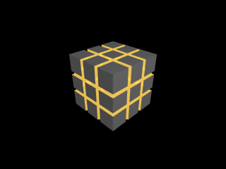

I have decided to do a series of glowing boxes, I dont know if I stole
this from anyone, if so, please let me know, and I apologize.  Here is a
partial rendering of the first one, with radiosity off (looks better
with it on, duh) and some artifacts that I believe are from AA.  If you
can tell me how to fix that, I would be quite thankful.  Its currently
AA adaptive .4 threshold, level 5 recursion, and .1 jitter.  I have a
lot going one because it was highly aliased, espescially at large
resolutions.  You can notice it at the edge facing the camera, the line
between dark and light is not straigt.
Thanks in advace.
Matthew Pace
Download 'box.png' (32 KB)
Preview of image 'box.png'
I think the area of the box that you mentioned is *not* being AA'ed, since
it consists of two shades of grey which are very close to each other (less
than .4). Try reducing your AA threshold (try .2 for starters) and see if
the problem goes away. (It should at least be reduced once you get the
threshold low enough.)
By the way, you probably don't need a recursion level as high as 5. I think
2 or 3 would do the trick.
 - Slime
 [ http://www.slimeland.com/ ]

> Its currently
It's better to lower threshold i.e. try treshold 0.03 (recursion 3, method
1 or 2, jitter mabe off, or .1-.5)
You seem to have a poor understanding of the AA parameters, maybe I can
help...
The threshold defines how much difference there has to be between two
pixels before POV-Ray will attempt to antialias them, treating each
pixel as having RGBvalues between 0 and 1; this value can range from 0
(AA everything except areas of no changes whatsoever) to 3 (only AA
divisions between pure white and pure black - in effect, nothing). A
good value to use for this while testing (if for some reason you're
testing with AA on) is .2 or .3, which is enough to get the effect of AA
but not enough to guarantee smoothness. For final renders, consider
using .1 or less.
The recursion defines how closely POV-Ray looks for edges; the higher
the recursion, the more supersamples it takes in order to define edges
and/or small details. In actual practice, a value of 2 is plenty for
test work, and anything above 4 is likely to be a waste; if you're not
getting enough detail at 4, you're probably better off rendering at a
higher resolution.
Jitter jitters the supersamples, essentially adding a small amount of
noise to antialiased areas, and should probably be avoided as a general
rule (IMO). In your case, I would say that jitter is responsible for the
"artifacts" you describe. Try setting it to 0.
You might also consider moving the camera or objects slightly so that
the division between the front faces falls along natural pixel
boundaries, if having the antialiased edge there REALLY bothers you.
-Xplo
From: Matthew Pace
Subject: Re: (32kb) WIP with artifact question - box.png (1/1)
Date: 4 Feb 2004 23:59:25
Message: <matthewpace-037BA6.20592304022004@news.povray.org>
>whole bunch of info
> -Xplo
Thanks a lot!
