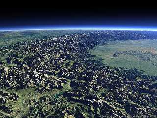

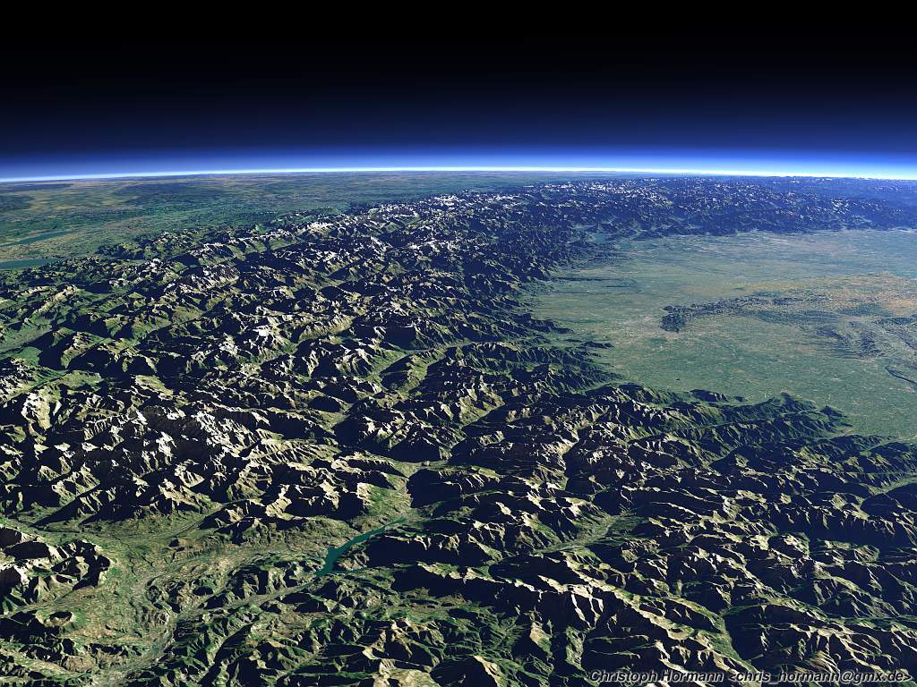

I have recently made some tests with compensation of atmosphere
influence in satellite images.  The problem of most high resolution
satellite images is that the color is influenced differently by the
atmosphere in different regions of the image and the same surface color
therefore appears as a different color in different areas of the image.
  The approach i took is to simply calculate the atmosphere thickness
for every point of the image from the corresponding height and use that
for compensation.  More details can be found on:
http://www.imagico.de/pov/earth_atmosphere.html
Attached are two renders from the alps, the first without the
compensation, the second with it.  Data sources are various Landsat
scenes for the texture and SRTM + void filling from
http://www.viewfinderpanoramas.org/ for the elevation.
Other renders using the technique can be seen on the Views-of-the-Earth
site (http://earth.imagico.de/new.php)
An implementation of the algorithm is available as well but this is not
a very user friendly program, just a demonstration.

The results are quite noticeable, even on the preview images. It's amazing
to see how much yellow-brown gets turned to green by the atmosphere.
Well done yet again, Christoph. And these are only preliminary results...
Subject: Re: atmosphere compensation in satellite images [161+188k]
Date: 6 May 2006 01:55:03
Message: <e3hdje$j99$1@chho.imagico.de>
Actually the atmosphere has a mostly blue influence.  The overall
difference in color between the two images is partly due to different
color balancing which has nothing to do with the atmosphere
compensation.  The compensation is mostly visible from the color
difference depending on altitude.

Christoph Hormann <chr### [at] gmxde> wrote:
Well, blue + yellow = green ...
> The overall
Now I get it. (I think :). So eventually your software will be able to give
the correct atmospheric compensation for any altitude? This sounds like it
could be complicated, since the atmospheric density varies quite a bit over
space and time.
If descending in an anim, will we need to use multiple image map files, or
will we be able to apply the required compensation by applying a correction
function to the image_map in SDL? I suppose the multiple map method will be
much faster than doing it in SDL.
Actually - no.
> space and time.
This is a very simplified model.  As outlined on the page i linked to
more complex compensations taking into account spatial differences in
the atmosphere density would require additional data and further
assumptions about the surface properties.
I have no idea what you are talking about.  This has actually nothing to
do with POV-Ray, it's about processing of images.
> Actually - no.
Ok. You're the expert. I just assumed subtractive mixing, like with paints.
Whereas yellow through a simple blue filter looks grey.
> > space and time.
Ok, I've read your full article now. Sorry, I should've done that before I
started with my comments...
I'm just talking about using this colour-corrected data in a raytraced,
animated approach to the Earth's surface.  What would one need to do to get
correct planet surface colour when seen at different altitudes?
Thanks for you patience with me, Christoph.
