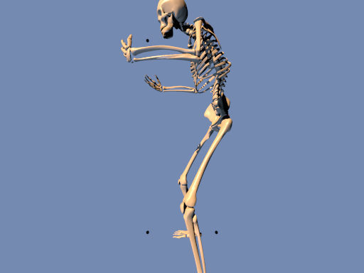

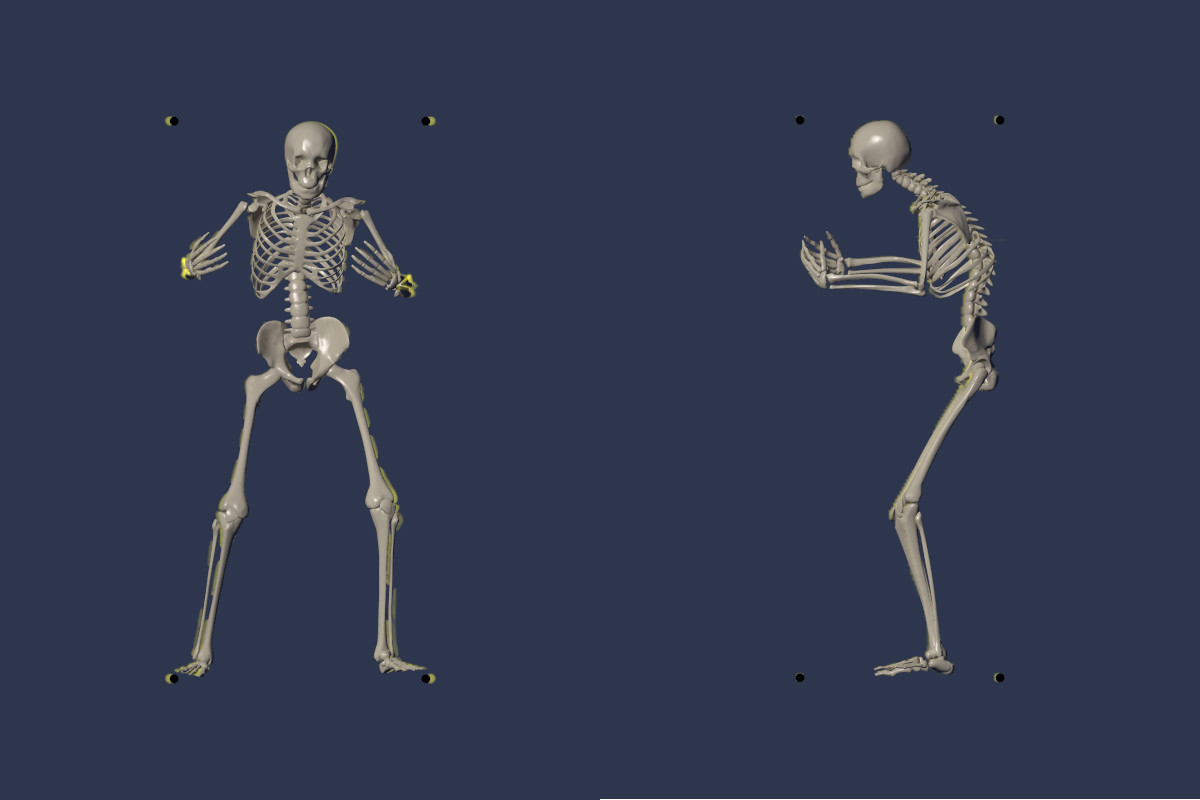

Now, how would you explain this?
I turned the models 90 degrees: we are looking along the x-axis of the
object to visualize.
Download 'gt_df3_test.png' (108 KB) Download 'makedf3object_.png' (40 KB)
Preview of image 'gt_df3_test.png'
Preview of image 'makedf3object_.png'

what is strange ?
The df3 describes a unit-cube, with distinct resolution along each axis,
but it is only a unit-cube.
So, with such model, you need a scale around 3 or so along the vertical
axis on the field to restore the kind of posture you had on the original.
Or did I missed again some red circle ?

On 28-9-2013 17:19, Le_Forgeron wrote:
> what is strange ?
Well, /that/ is exactly what I am wondering. Does the df3 /always/ scale
to the unit-sized box? whatever the bounding box of the object is? I
probably missed something but I do not remember having read this anywhere.
That puts my earlier observation of squeezing into another light...

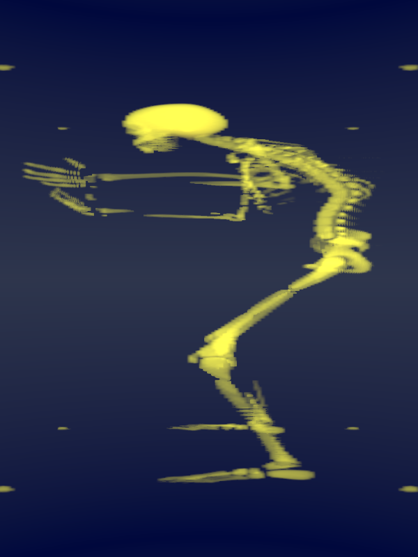

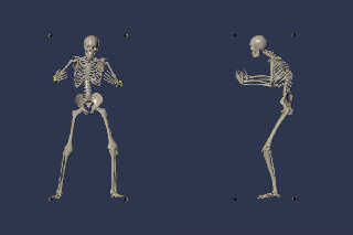

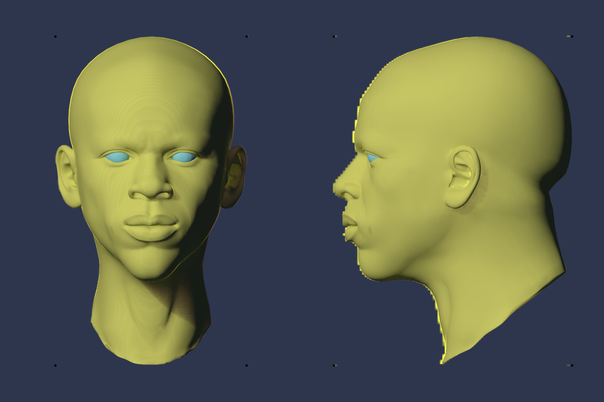

There is still something that I do not understand.
I have now scaled back the df3 files, using for a defined object Obj:
#local Min   = min_extent(Obj);
#local Max   = max_extent(Obj);
#local Size  = Max-Min;
Superposing the object and the df3 files, flipping the df3 files along y
(Gilles Tran), and resizing the df3 files, I note the following:
1) the x-axis needs also to be flipped! Visible especially with
asymmetrical objects (skeleton)
2) the skeleton df3 needs an additional x-axis scale correction: scale
<-3.0,-1,1>*Size
3) the head df3 needs a /different/ x-axis scale correction: scale
<-2.3,-1,1>*Size
The two images show orthographic views.
Question: If the df3 are made to a unit-sized box, why does the x-axis
need a correction different from object to object?
Download 'gt_df3_test_1.jpg' (54 KB) Download 'gt_df3_test_2.jpg' (73 KB)
Preview of image 'gt_df3_test_1.jpg'
Preview of image 'gt_df3_test_2.jpg'
