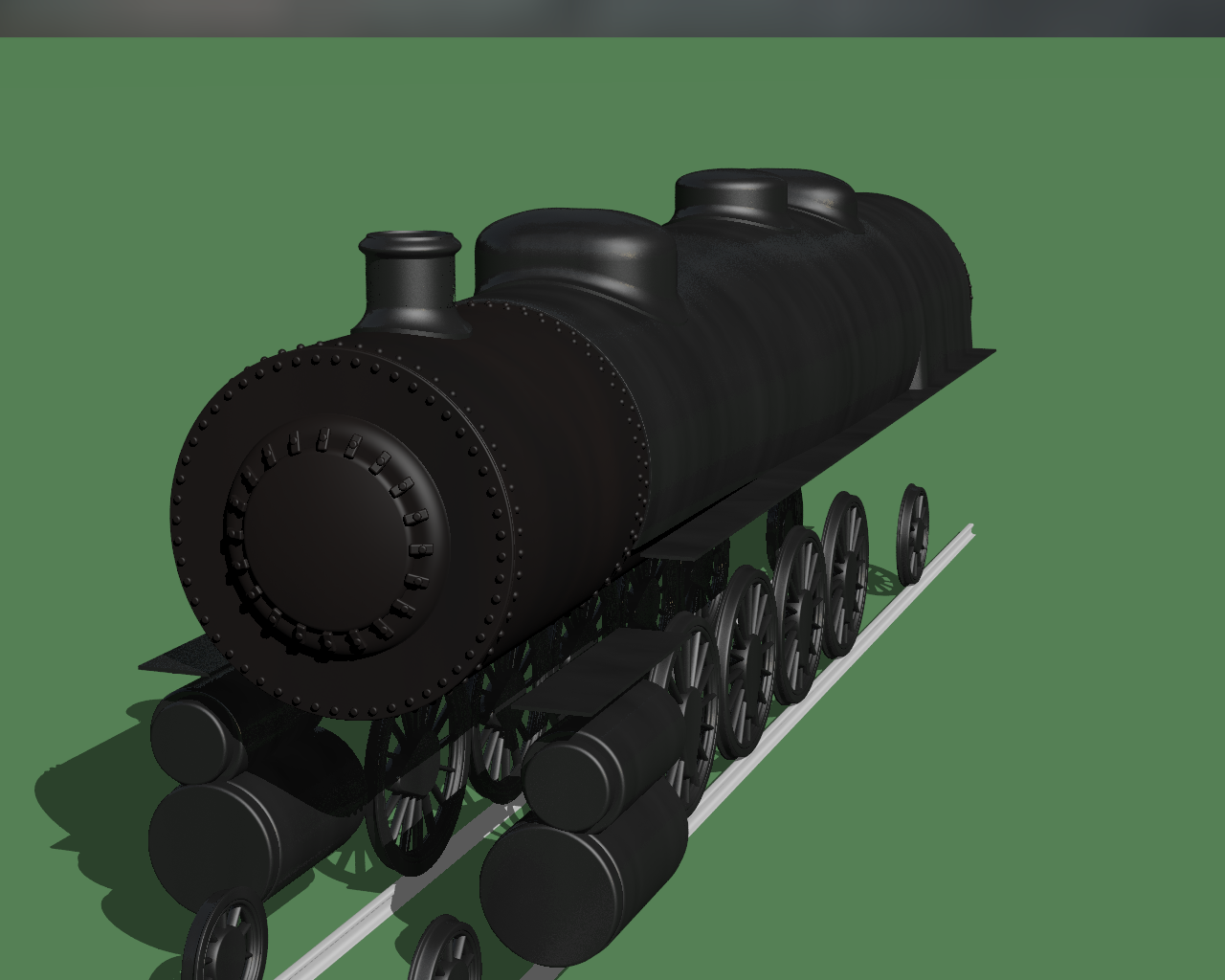

Found some time at last to get back to this model again.
So far, I've been able to stick to solid CSG modelling.
The boiler fairing was quite straightforward as expected, being
basically just a spline lathe. The firebox fairing is a spline prism
(actually two copies tilted a bit along the boiler axis) and to my
surprise fits snugly with the lathe.
The smokestack is a blob construct; the upper rim turned out differently
than planned, but I think it's perfect as it is. I'm a bit worried
though whether I can use the same approach for the steam dome and sand boxes
Boilerplate "decoration" is just a bunch of rounded boxes and -cylinders.
Well, still a long way to Tipperary...
Download 'steam.png' (709 KB)
Preview of image 'steam.png'
...crossin' some plains?
-Ive
Cool work from what I can see.
Perhaps test render in a flat white texture so it's easier to see details.
-tgq

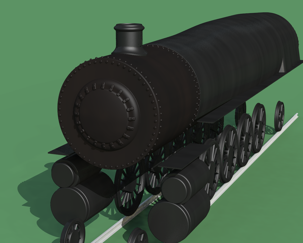

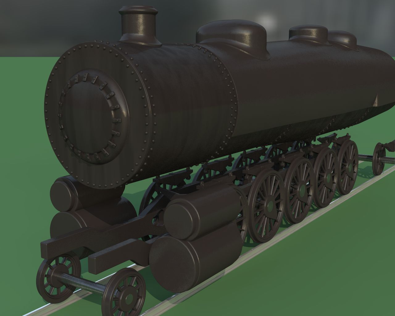

Absolutely :-)
Though they won't be this green...
I even got a perfect-fit quote from the book.
BTW, the steam dome and sand box "humps" were actually easier than I
would have thought. Not exactly to the blueprints, but could you tell?
(For some reason though they remind me of German WWII helmets :-P)
I was really worried about those; now that I got them, I'm confident
that I'll indeed be able to make it an all-CSG object.
Download 'steam.png' (455 KB)

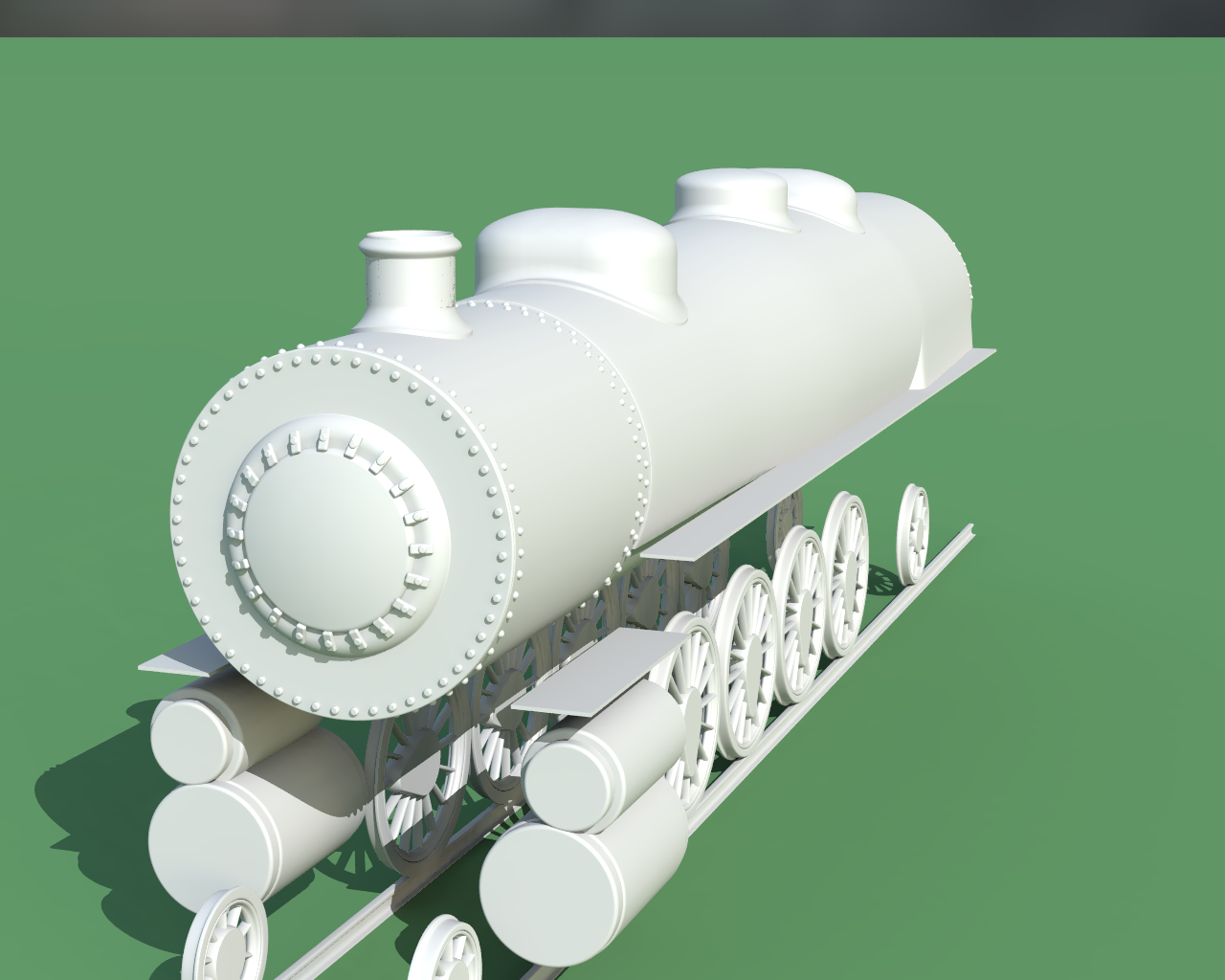

Thanks - though such things are usually supposed to be steaming hot :-)
Well, I didn't want to bore you, but since you ask for it... I think the
black version is more impressive though ;-)
(BTW, someone knows how to get rid of the artifacts at the smokestack?)
Download 'steam.png' (492 KB)

Message: <4ab291da$1@news.povray.org>
Ah well, never mind...
(Lesson learned: When punching a hole into a blob with a smaller but
stronger blob, make sure that it leaves a substantial wall thickness... >_<)

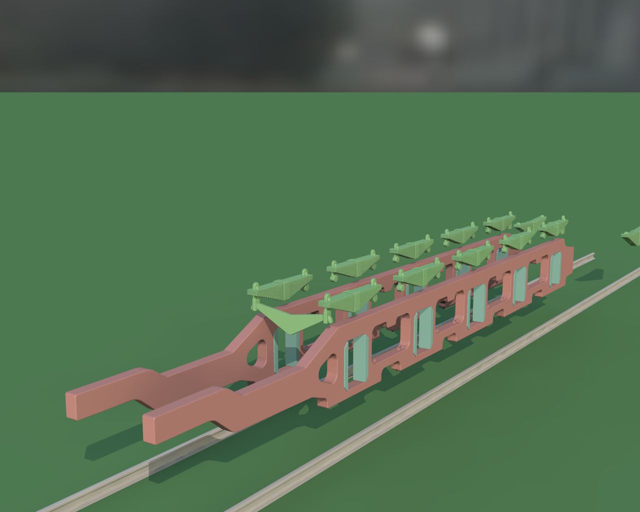

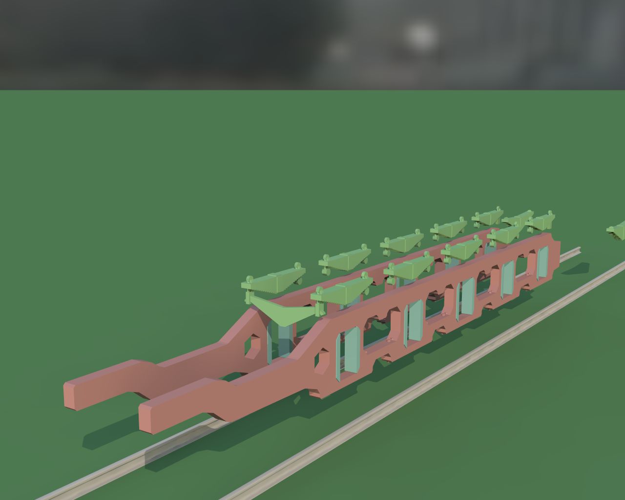

From: clipka
Subject: Re: Picking up steam... slowly...
Date: 20 Sep 2009 21:00:25
Message: <4ab6d029@news.povray.org>
Growing a chassis...
Problem #1 that had to be solved: Develop a framework to generate nicely
beveled prism-like objects.
I wasn't sure whether I could pull this off by combining sphere_sweep
and prism objects in some mathematically smart manner, so I ultimately
settled for a nice framework to specify polygons with basically linear
outline, but rounded off at the vertices with circular arcs of arbitrary
radius. This also makes the whole thing easier to control.
The downside is that the heavy use of CSG already starts taking its toll
on rendering times, so I needed a quality parameter to switch beveling
off for quick test renders.
Problem #2 to overcome: Decipher the blueprints. (fortunately I do have
some at all :-))
Download 'steam.jpg' (80 KB) Download 'steam_1.jpg' (55 KB) Download 'steam_2.jpg' (51 KB)
Date: 22 Sep 2009 03:37:16
Message: <4ab87eac$1@news.povray.org>
Impressive and interesting. Nice texture too. I am curious to see how long
you will be able to sustain the CSG construction before render times become
unmanageable...
