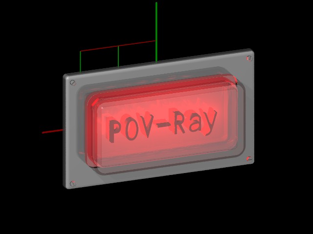

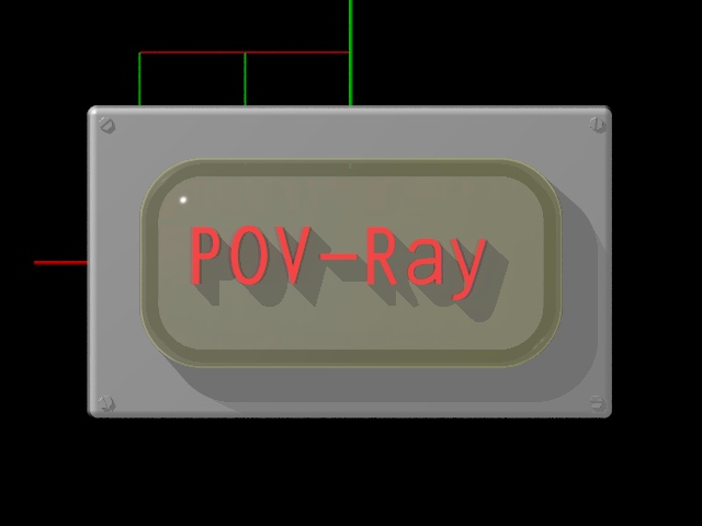

I'm working on some buttons for a website. It's far from complete but here
is the first result.
I'd like to put some lights in the button so that I get the effect that the
text inside the glass is emitting light. It's should then illuminate the
rest of the button.
So far I haven't found a good method to achieve this. I tried area lights
but the the letters start casting shadows. I've also tried to put some
cilinder  with rounded top & bottomwith transparent media around the text.
But this didn't look very nice either.
Anybody has a suggestion how to make text that emits light and how to get a
kind of halo effect around the text?
I also tried lights and looks_like with the text inside but that didn't seem
very realistic either. Looks like a light spot in the center of the text.
Here is the code w media I tried

Here's a new render
I've put 8 lights under the ruby glass cap which is below the white glass
cap.
Looks a bit better, but still far from what I have in mind.When the text
itself could emit light that would be much nicer.
I think the final render should become more glossy. Maybe making the glass
cap on top thinner makes the colors somewhat more brilliant. I still have to
experiment with the glass textures. I think the inner colored glass should
be more matt so that it disperses the light. The outer glass should be
lighter I guess

From: Johan Feyaerts
Subject: Re: web buttons
Date: 25 Jun 2006 13:15:02
Message: <449ec496@news.povray.org>
"Wijnand Nijs" <w.n### [at] alf4alldemonnl> wrote in message
news:449e7d09@news.povray.org...
>I like this button and the discussion very much. I am working to make my
> whole side povray-style (still a little bit primitive, but...), see:
> http://alf4all.demon.nl/frames/index.htm
> So, if there are others with good idees and/or code ..., let's make it a
> topic.
> greetings...
> Wijnand
Download 'buttontestsideviewwarealights.jpg' (24 KB)
Preview of image 'buttontestsideviewwarealights.jpg'
