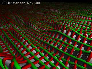

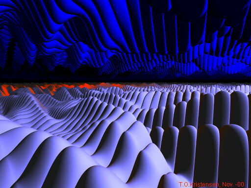

I wanted make some cylinders that were "bent"
according to a random pattern by using an iso-
surface.
I haven't succeeded doing this yet, but here's
an intermediate result. I'm not sure at all
if it's possible to do what I want with an iso-
surface. (But I'm trying.)
This image shows two iso-surfaces.
Tor Olav
mailto:tor### [at] hotmailcom
Download 'spaghetti.jpg' (54 KB)
Preview of image 'spaghetti.jpg'

I don't really understand the problem, because bending isosurface objects
usually isn't that difficult, maybe you should explain a bit more
detailed.

Some emitting media near the horizon and a different texture for the upper
part would make it look quite interesting IMO, but it's probably more a
technical study.

I have enclosed an image that shows some
iso-cylinders that I have tried to bend
so that they follow the iso-surface below.
The problem is that they look like flattened
hoses whenever they "move" vertically.

There are 3 iso-surfaces in this image;
a red, a green and a white one.
Tor Olav

Ok, you didn't say that was the problem...this method acts like
displacement mapping, it pushes the surface around without caring about
the overall shape. You want something that acts like a sphere_sweep...
and I think you will have to use a sphere_sweep to get it.

Its' probably in effect a sweep of a vertical circle, not of a sphere. There may
be some workaround to get a function of distance from the center of the hose,
but don't look at me!
Yes I agree, and I've been bending my mind to try
to come up with something that will enable me to
do something like a sphere sweep in there.
The problem is that the center of the "hose" does not
lie on a straight line anymore when it is being pushed.
I think that maybe one could try to find the slope and
direction of the line in the region where the current
point is and then try to find the point on that line
that is closest to the current point.
And then (I think) one could sample the "pushing"
pattern in front and behind the point that are used to
decide the "pushing" amount, in order to estimate the
slope.
But again:
My PC is to slow to let me explore this :(
(And I don't feel for doing this right now either :)
Tor Olav
