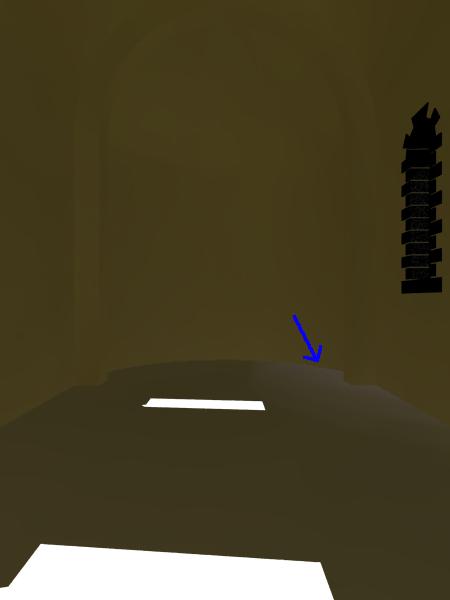

This picture was rendered with unimegapov v0.3. I'd like to
know where the white zone comes from. Here are the symptoms:
* it appeared when I put the stonework around the window
frames;
* it only occurs with radiosity, and it's there no matter
what recursion level I use;
* it's the same no matter what color I give to the stones;
* some tests showed that it appears as soon as I put 5
objects or more in one or the other of the windows, not
matter what objects or what color they are;
* it dwindles to nearly nothing when I increase the
neares_count and decrease the error_bound, but then of
course the render time increases drastically;
* the scene is lighted mostly whith radiosity (the ambient
is very low, there is just the sun outside, and a slight
shadowless fill-light at the camera position).
	Anybody knows what could cause that?
		Jerome
Download 'radio.jpg' (7 KB)
Preview of image 'radio.jpg'

My guess would be that light is 'leaking' in from outside of the wall due to
too large of a value for error_bound.  Other than that, I'd only be
guessing, unless it is a bug.  I don't know why the number of objects in the
scene would have an affect on the radiosity (at least when the color of the
objects has no effect).
-Nathan

Nathan is the expert on this sort of thing, but I seem to remember something
of a similar nature happening with an image that someone here was working
on over a year ago, something to do with autobounding kicking in.
Try with 5 100 per cent clear objects. Just a thought.

	Thank you both. Lowering error_bound does the trick,
eventually (1 is still too much), but the render time
skyrockets. Removing auto-bounding fixes it too and allows
for faster render (actually, by manually bounding my
objects, I'm able to get render times similar to those I get
with auto-bounding) so I guess there must be a bug somewhere
	Anyway, thanks again to both,
