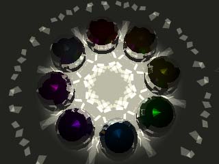

try and use this :
#declare fReflect =
finish {
	ambient 0.0
	diffuse 0.079133
	phong 1.0 //Not necessary. lower it .
	phong_size 60.263333
	metallic 1.0
//	reflection 0.8 //nope.
#macro t_reflect(vColour) //vColour is a 3 post vector
texture {
	pigment { colour vColour }
	finish {
		fReflect
		reflection 	vColour
		ambient		vColour/10 //or something low.
#end
This will give you nice reflections on a solid shape.
notice me and I'll give source for my reflections image.

Like Spider's code demonstrated, POV's reflection is not based on the pigment.
The color of the reflection is specified by the reflection keyword.
  reflection <1,0,0>  // this will reflect red
Of course, this is kind of annoying if you want to reflect a complex pattern.
I've got a suggestion for this... read about it in povray.programming.
-Nathan

Ken,
I'm not sure if that is the problem. The mesh object I'm using is not in any
CSG operations or anything like that, it is just in the scene. It produces
reflective caustics fine, but the caustics are not coloured. The meshes are
very reflective, and all have a strong colour (such as red 1 green 0 blue
0). I have posted a small pic to show what I mean. The reflected caustics
should be coloured by the objects as in Spider's scene, but instead they
stay white. I'm guessing it's one of my settings, but I'm not sure what to
do.
Equiprawn
