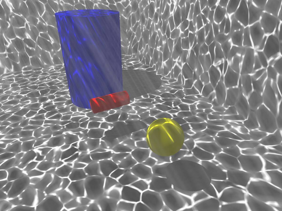

HelloI would like to extend my scene with the fake caustic to see the light rays
under water. With a scattered media this works, but the computation time
increases indisputably from 0.5 to almost 70s per frame (should become an
animation later).
In the concrete scene the samples have to be at least 50,100 for this to look
usable - so I can't turn the screw anymore.
What possibilities are there to speed up the process (I think that the
calculation time/image should not be more than double or triple, but not by a
factor of 100)?
Is there a way to fake this (similar to what I did with the caustics), but for
the scattering media I have no idea at the moment.

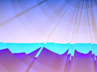

Since it's a shader, it all needs to be converted into functions, and then
rendered as a pigment pattern that controls an average texture.
That took a little bit to make a little 200-line scene, and winnow out all the
stupid trivial mistakes.
I suppose I ought to animate it to see what that looks like....
Download 'lightraytest.png' (282 KB)
Preview of image 'lightraytest.png'

From: Bald Eagle
Subject: Re: Speeding up (or faking) scattering media
Date: 21 Jun 2023 14:50:00
Message: <web.649345363f9195661f9dae3025979125@news.povray.org>
"jr" <cre### [at] gmailcom> wrote:
> yes :-)
tl;dr
Short 5 second animation attached.   500 frames at 10 frames/sec.
I guess it looks ok.  No idea why it looks so different from the beautiful
Shadertoy result.
Download 'lightrays.mp4.dat' (2177 KB)

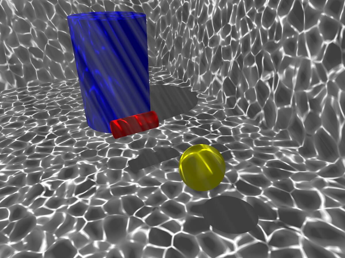

Hi,
I made a few attempts over the weekend. I followed the variant "transparent
cylinder". The result looks quite usable, but there are a few restrictions and
things to consider.
In the core I use a (vertical) cylinder. On this cylinder is a gradient texture
to avoid sharp edges. Finally, the cylinder is rotated so that it is parallel to
the light rays.
The constraints are:
1. there must be no visible intersection of a cylinder with another object in
the scene, here you would have sharp, unnatural edges.
2. the gradient texture must be aligned with the camera, otherwise the advantage
of having no sharp edges is lost,
3. not too many of these cylinders should be used (about 150), otherwise the
render time will increase again to the point where you can use the right media.
Download 'lightsource2m1b.jpg' (118 KB)
Preview of image 'lightsource2m1b.jpg'
