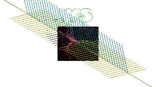

Image of work so far attached.   It's halfway there, though I'm guessing at
magic rotation angle numbers and just flying by the seat of my pants through
intuition.
Apparently there's a much better way to do this that's used in multiple view
geometry in computer vision, but it uses QR decomposition and SVD, among other
matrix operations.   There are Matlab libraries to do some of this, but it would
of course be preferable to be able to do this ourselves in SDL/source.
> intuition.
Haaa, what I see !
You started 3D reconstruction of Yes-related staff with photogrammetry ...
Very interesting, but it seams to me implementation will be not easy, as we have
only one-view here.
In any case, please tell me if I can help you with some Matlab's methods, you
know, I have one )
