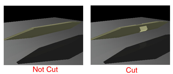

Thanks. That helps some, but it is still trial and error.
I have used UDO's in the past by generating the object using a cad
program and importing it in to Moray. However, when you cut a UDO the
light which comes in the hole is visible on the outside of the object.
The picture attached shows a UDO object both with and without a hole
in the far side. As you can see there is a bright patch on the near
side from the light coming through the hole.
I am trying to make the object in the picture using CSG, but figuring
the angles to cut the tapered ends is difficult.
Stefan
