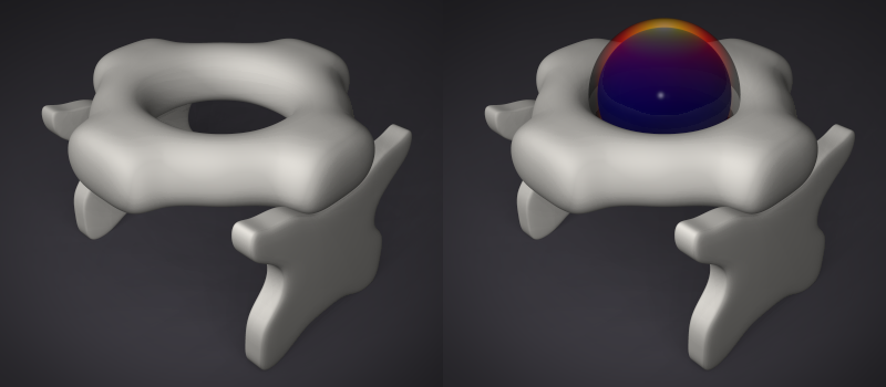

As a part of a scene, I create the figure shown below (on the left side - WIP
and untextured).
In the center of this model, I want to place a dark-blue, glossy
sphere, encased by a red aura.Wheras the red aura should
on the top more bright....and of course this shoud looking
very magical.
In my attempt (seen on the right side) the red aura is too hard and clear
and looks very "unmagical".
The code is this:

So I want to ask you....how can I do it better ?

First thing I notice is that the aura container is visible; this may be
intentional, but I think it makes the whole thing look crappy. So I'd try with
rgbt <0,0,0,1>. Also make sure that you don't have any finish on it (i.e.
ambient 0 diffuse 0 specular 0).
The next issue is that media effects totally filling a container generally don't
lool too convincing, so you want to have the density fall off towards the
outside.
You can achieve this by using a second density{} statements in the media, using
e.g. a properly scaled onion density map; this will effectively multiply both
densities, i.e. where any one of them is zero the total density will be zero,
and only where both are 1 the total density will be 1.
You may also want to give the whole thing some irregularity - you can use a
third density map for that, using a bozo pattern and some warp turbulence, for
instance.

I was wondering about your cylindrical pattern. I think there is a better (and
more controllable) way to get what you want. Here is what I came up with; it
uses two spherical densities, combined in an 'averaged' density_map. It also
shows that you can scale, translate and even rotate an individual density
inside your media sphere.
Replace your 'aura' sphere with this, and see how you like it.
Ken W.
